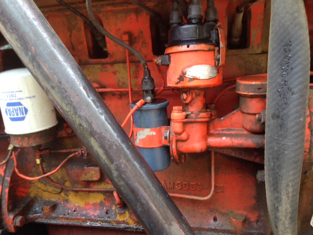

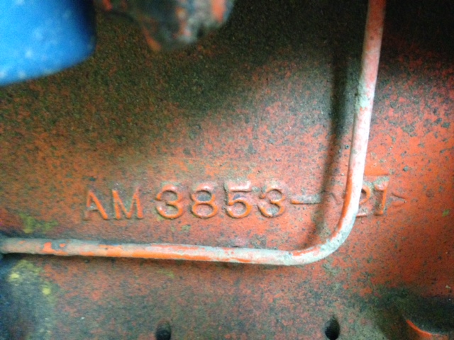

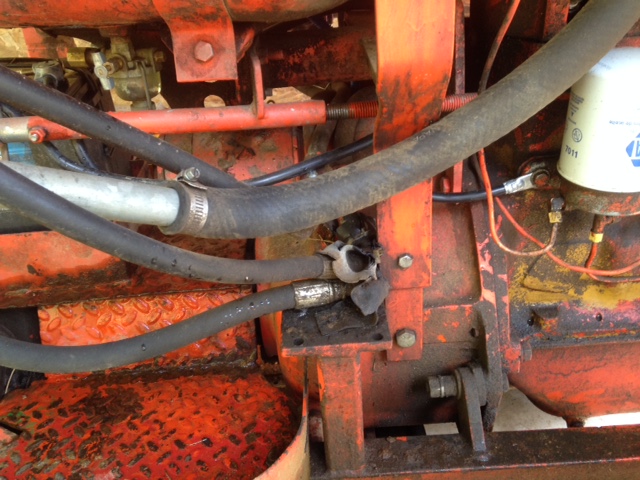

I took another look at my dozer today I think the motor and bell housing are from wd 45 then it's married to the HG transmission. I used it a little over the weekend clutch works great sometimes but not diisengage some times. It does not slip at all. I took some pictures but could not figure how to make them small enough to post on here. The motor block has a stamp of AM 3853-21. Are all wd45 engine clutches the same? I need to get a kit ordered up thanks

Post Options Post Options   Thanks (0) Thanks(0)   Quote jkoepke Quote  Post ReplyReply Direct Link To This Post Posted: 26 Aug 2018 at 11:15pm
jkoepke View Drop Down
Joined: 01 Mar 2012
Location: idaho
Points: 32
Post Options Post Options   Thanks (0) Thanks(0)   Quote jkoepke Quote  Post ReplyReply Direct Link To This Post Posted: 26 Aug 2018 at 11:17pm
Joined: 01 Mar 2012
Location: idaho
Points: 32
Post Options Post Options   Thanks (0) Thanks(0)   Quote jkoepke Quote  Post ReplyReply Direct Link To This Post Posted: 26 Aug 2018 at 11:22pm

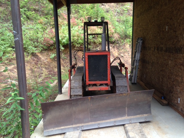

Post Options Post Options   Thanks (0) Thanks(0)   Quote shameless dude Quote  Post ReplyReply Direct Link To This Post Posted: 27 Aug 2018 at 12:42am
that's a sweet looking little dozer! I don't think you'll hafta take it apart, prolly just do sum adjustments. it' don't look like it's been abused!
JC-WI View Drop Down
Points: 34430
Post Options Post Options   Thanks (0) Thanks(0)   Quote JC-WI Quote  Post ReplyReply Direct Link To This Post Posted: 27 Aug 2018 at 10:11am

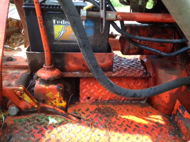

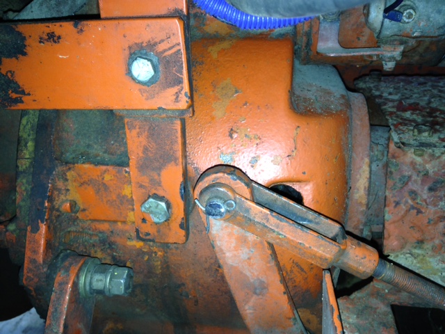

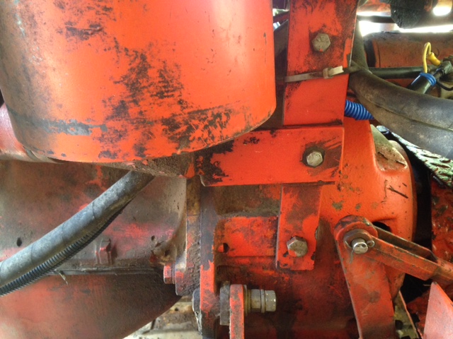

Okay, the engine looks like a WD45 engine, the clutch /flywheel housing may have come from a 100 combine... if it is foot clutch, it will be a spring loaded clutch, if it is a hand clutch, that will be a snap over designed clutch such as a rockford.
 The tracks look like they are from an HG oliver.
 Thanks for the pictures.
