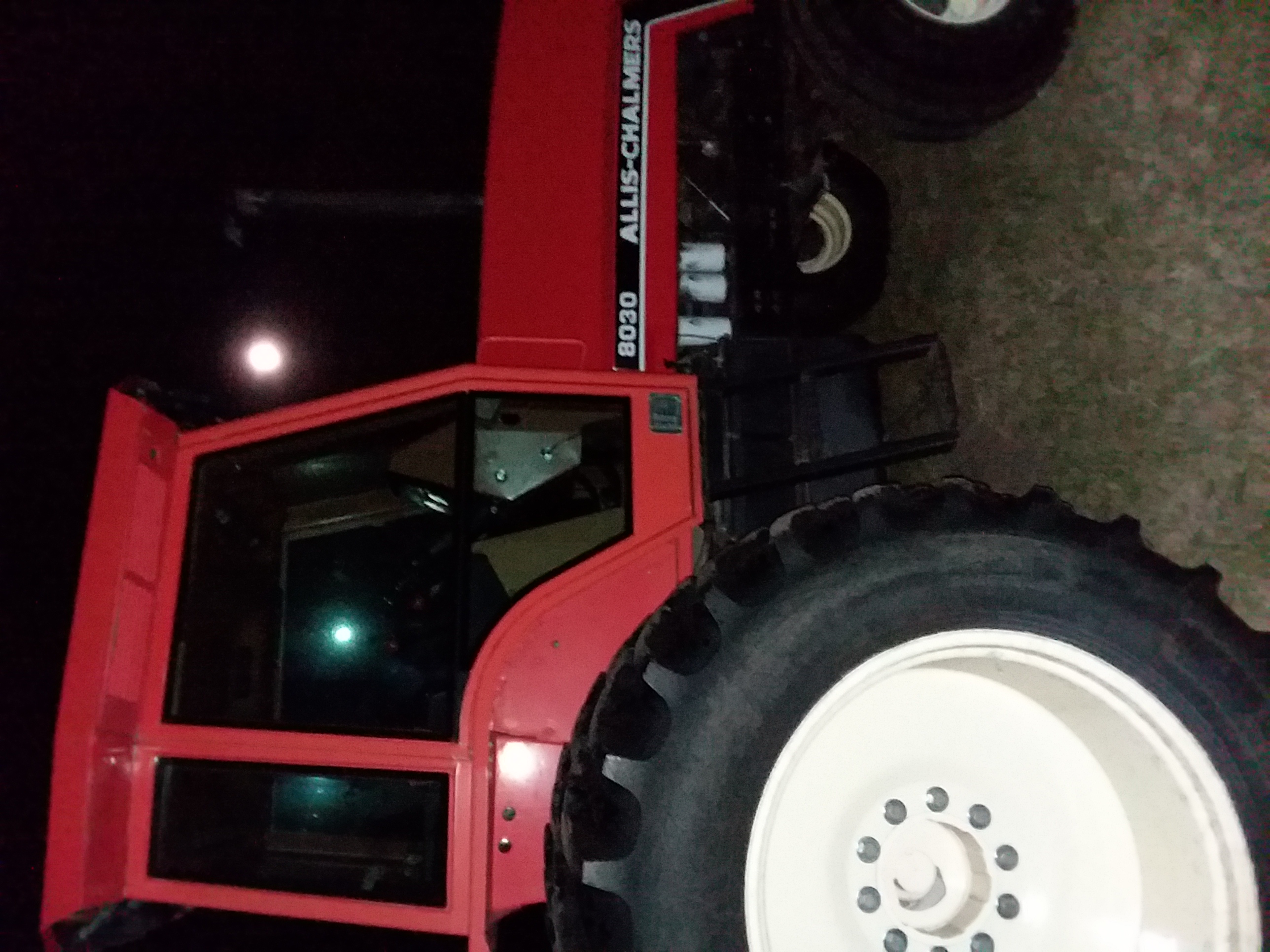

I bought a can of agco, took it to my paint man. He got this mixed, it is not a perfect match, but i think it is better than rattle can paint job would be.

sorry this is all the better picture i have right now. The dual wheels were painted with nasson. The hubs were agco rattle can paint.
