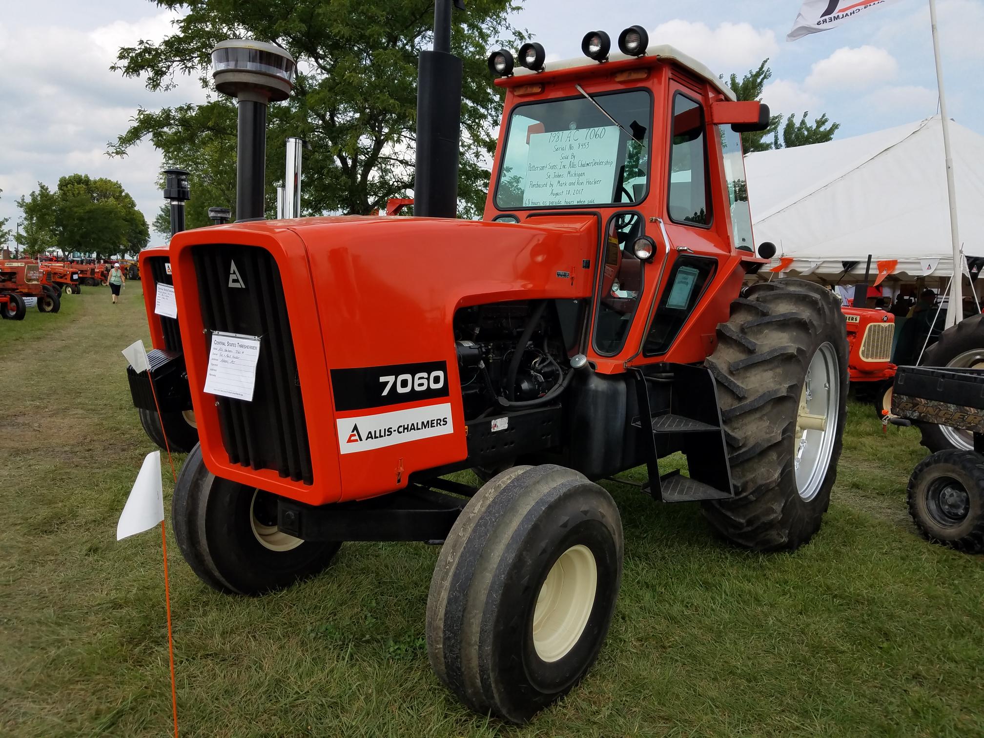

I started this thread 3-1/2 years ago and I still don't know what to use for a 7000 series black belly.  However, at the GOTO in Pontiac last year, there was 7060 black belly that was from the Patternson dealership in Michigan that had NEVER been sold until 2017, and it had Cloud White wheel centers.  It was also featured in the Fall 2019 Old Allis News on page 19.  I also have several color sales brochures of the black bellys that show cloud white wheel centers.
I wonder if of 10 or 40 years, the cloud white fades to a true white.
Here's the pic I took at Pontiac, and the wheels look cloud white to me.  So, I'm staying with cloud white.

It does look like the cab top of the 7060 is (faded?) lighter than the wheels which appear pretty close in color to the “cream” on the D-series behind it. (I guess we’re assuming those 7060 hubs/wheels were never touched up???) Looking at original 6 and 8000 series literature, it looks like there could have been a couple different shades of “white”. Some of the literature could have been pre-production though... I wonder if the wheels and hubs could have been painted by a supplier (or different batches of paint) and therefore had some differences as well. The white on the tractors in the Loretta Lynn ranch ad movie on YouTube does seem to be pretty white, but maybe the film faded?

Just checking my eyes here the rears look different than the fronts to me in this picture. Am I just being fooled by angles and light.

looks to me the rim is silver, the hub cloud white

My 1975 cotton stripper has the "cloud white" creme colored wheels, and the brighter white cab of a Gleaner L/M. Been barn kept since new, so not too much sun fading.
