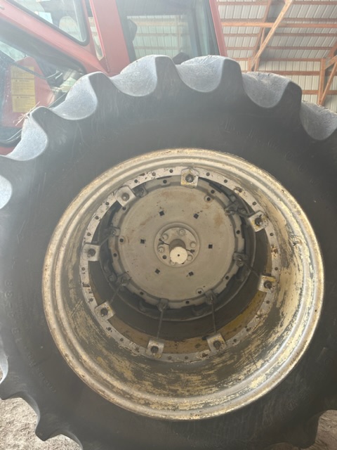

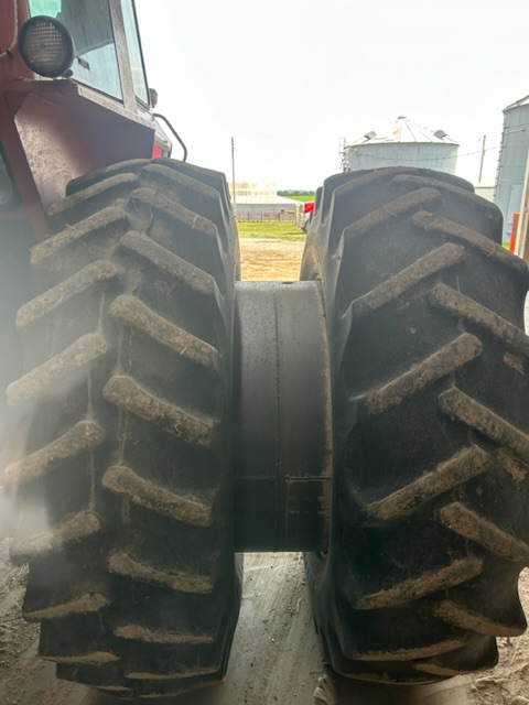

Post Options Post Options   Thanks (0) Thanks(0)   Quote skateboarder68 Quote  Post ReplyReply Direct Link To This Post Posted: 30 Jan 2024 at 9:23pm
This was on a 7045, got along great for many years. Had an extra band width welded on to make for 30 inch spacing.

My 7060 has nearly the same setup as skateboarder68's 7045 spaced duals. I measured it's spacers & tire centers as follows.
18.4-38s, DMI clamp on duals with 2 - 8.5" steel band spacers (17" combined).
inside tires set at 62" centers.
outside duals set at 122" cenrters.
It does tillage, mowing, planting, etc and never has any issues. It's rear wheels each usually have 3 - 300 lb Martin? outer wheel weights. If it doesn't need the weight, they can easily be removed with forklift & an air impact. Same for the duals. If they're not required, a 4x6 wooden block under inside tire to lift weight off dual, then an air impact can remove them in 5-10 minutes & they're rolled away to lean against something until later. Biggest challenge to remounting clamp-on duals is to get them tight(initial tighten, brief drive/check, re-tighten, another brief drive/check again, re-tighten as needed...).
