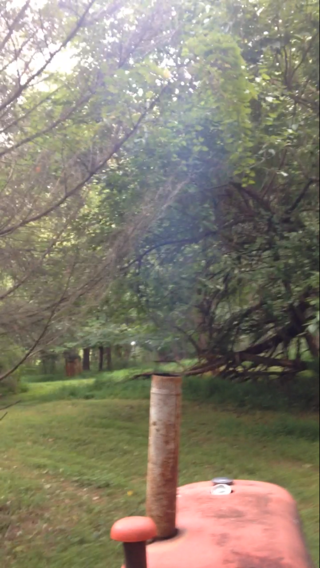

I have mowed with my WD45 for 31 years and developed confidence in the oil pressure which led to the bad habit of only checking pressure on start up. Consequently, I didn't observe a problem until the governor kicked in when there was no load on the tractor. That is when I observed steam and smoke due to over heating. The pressure gauge was missing and the oil had been pumped out of the port.
Based on the smoke from the exhaust, I damaged the pistons and liners for sure. I don't hear an obvious bearing. Knock, but I really don't know what to listen for.

Actually, that don't look like the most oil I've ever seen, coming outta a WD exhaust.  If it were mine, and not knockin, I'd let her be, continue to run, just add oil as necessary...Thumbs Up
