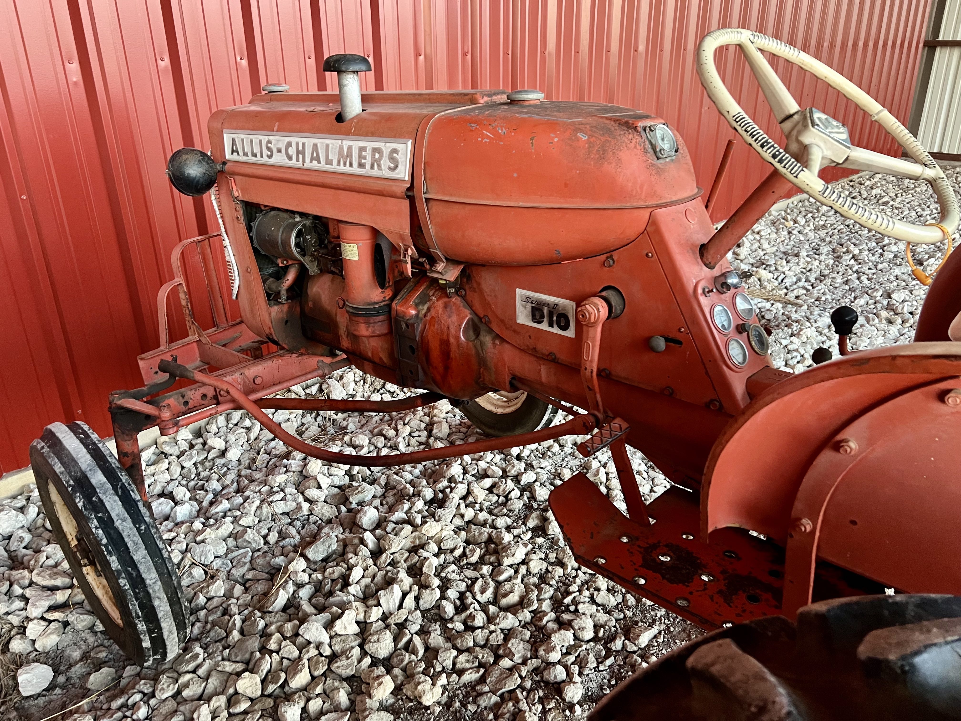

I just picked up a D10 Series 2. I plan to use it as a working tractor for spraying and running a side-mount sickle for cutting around my pond and banks. I'll do a tune-up and see where I go after that. It runs and shifts well. I do get a bit of noise when the clutch is depressed. I might be splitting the tractor soon.
The paint looks original and is well worn but solid color, so I will likely keep it for more of the original look. I like the color, so I need to find a good match; it's a 63 so assuming PO2

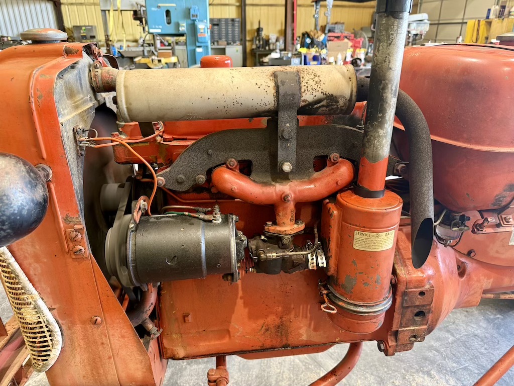

I've never seen exhaust on a D Series as this tractor has; it Looks factory, though.

does it have an under hood muffler... or just a straight pipe off the manifold ??

It has a muffler.   I did see that a low-clearance model is an option; this is the first time I've seen one.

   Yes that Low discharge exhaust is an Option. I've seen a few however I've never seen on that the muffler wasn't burnt out. It's nice that you have the normal exhaust factory hole filler.

That tractor has the under hood exhaust. My neighbor has a D12 like that.

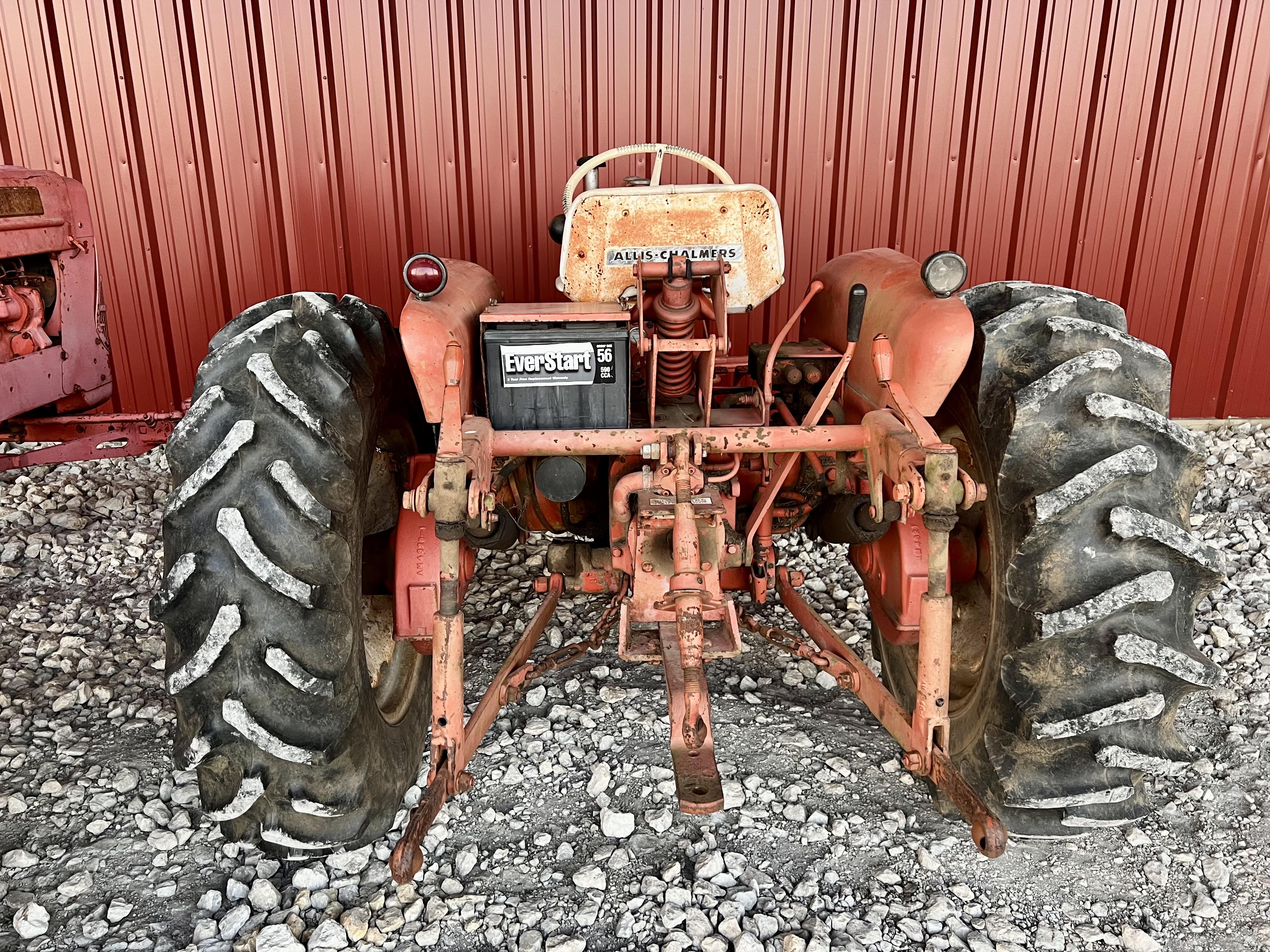

That tractor was a drawbar work tractor mostly. If the 3 point had been used muck, the yokes wouldn't stand up like they do. JMHO, Tracy
