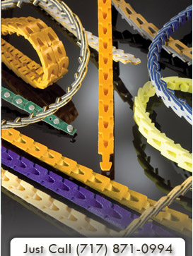

Or you can do this!!!!!!!!!Put a link belt on it! Fast and easy!!!! We have ran this style belt on our forklift with pump drive for years & Thousands of hours and its still good as new. Most Industrial places carries it. Here's link to one of the manufacturers.
http://www.fennerdrives.com/nutlink/_/NuTLink-B/17/5L/
http://www.bdhbelt.com/link-v-belts.asp
