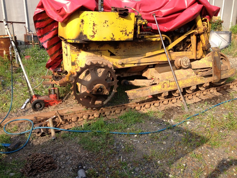

    Posted: 07 Jul 2012 at 3:34pm
nothing better to do on the hottest day of the year. took 4.5 hours to split the track, move the track frame forward, remove outboard bearing(cut off shaft) remove sprocket, shaft and bullgear. reinstalled good shaft, adjusted bearing preload and set sprocket back on. whew, i am tired. need a cooler day to finish. i will post pics once i resize.

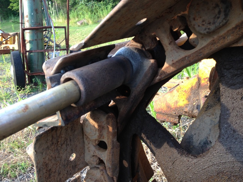

Post Options Post Options   Thanks (0) Thanks(0)   Quote dadsdozerhd5b Quote  Post ReplyReply Direct Link To This Post Posted: 07 Jul 2012 at 3:57pm
homemade pin driver holder. used old bushing welded to track pad. broke off once as hardened pin does not weld well. worked good as i had noone to hold pin while i swung sledge. i don't know why, i am a dead eye. i only missed a few times. lol

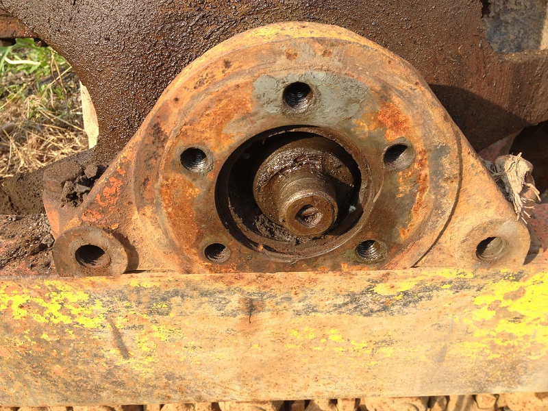

Post Options Post Options   Thanks (0) Thanks(0)   Quote dadsdozerhd5b Quote  Post ReplyReply Direct Link To This Post Posted: 07 Jul 2012 at 4:22pm
this is the reason for the shaft change. no lube on the outboard bearing. shaft was not drilled and no lube since install in 1986. they just don't make em like they used to

Post Options Post Options   Thanks (0) Thanks(0)   Quote dadsdozerhd5b Quote  Post ReplyReply Direct Link To This Post Posted: 07 Jul 2012 at 4:24pm
track and frame out of the way. time to remove the outboard bearing and sprocket

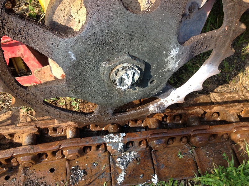

Post Options Post Options   Thanks (0) Thanks(0)   Quote dadsdozerhd5b Quote  Post ReplyReply Direct Link To This Post Posted: 07 Jul 2012 at 4:26pm
shaft shot so i used the hot wrench. neat smoke while cutting.

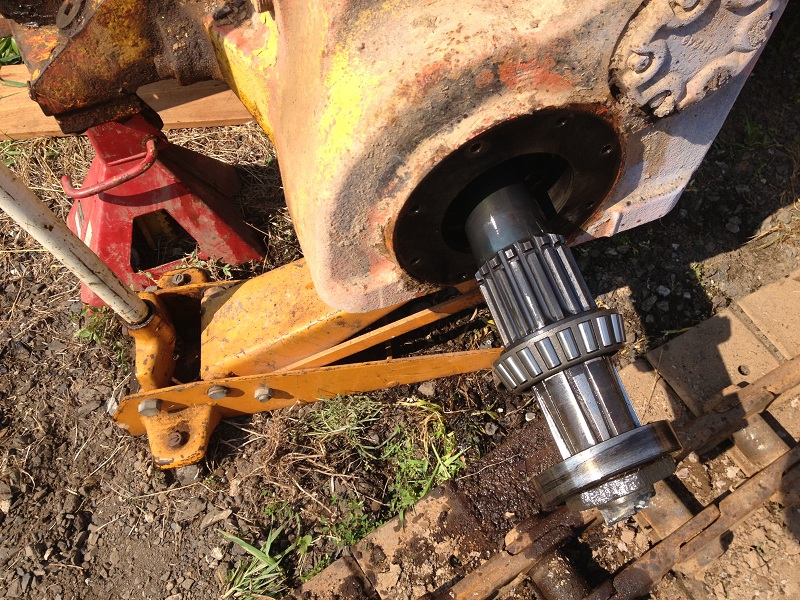

Post Options Post Options   Thanks (0) Thanks(0)   Quote dadsdozerhd5b Quote  Post ReplyReply Direct Link To This Post Posted: 07 Jul 2012 at 4:28pm
sprocket was loose so it almost fell off once i removed the nut. removed the lock ring and seal retainer and with the help of my trusty forklift, shaft came out. woo hoo!

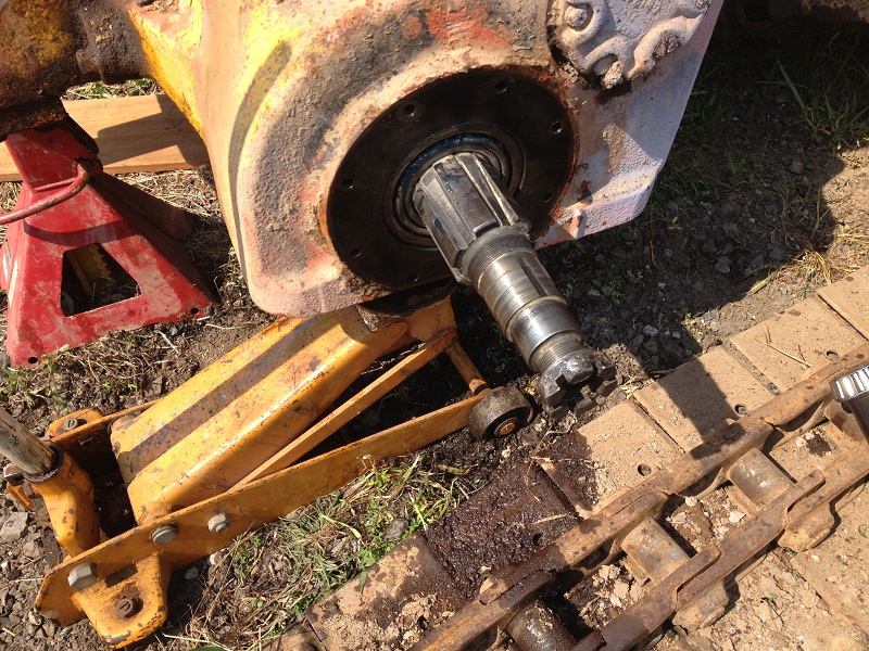

Post Options Post Options   Thanks (0) Thanks(0)   Quote dadsdozerhd5b Quote  Post ReplyReply Direct Link To This Post Posted: 07 Jul 2012 at 4:32pm
out with the old, in with the new. good shaft in and ready for retainer and seal. i got seal in and it was getting closr to 100 degrees so i had enough before the heart attack set in. now to finish with the sprocket and outboard bearing, change the rollers, free uyp the adjuster, change the tracks, it never ends. sad part is the outboard bearing is shot on the other side. i just hope the shaft is still good. in fact i prayn the shaft is good.
