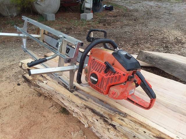

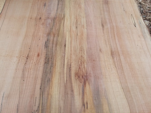

Here are a couple pix. of the mill and the slab process.--Need to skin the bigger logs down so they fit on the band mill. thanks; ac fleet

What does something like that cost, and where did you get it....? Thanks, Darrel

Wow.  I'm impressed on how smooth the cut is. Thumbs UpThumbs Up

I have to ask. What are you using as your guide for the first cut?

Cost, they start at $150, plus saw.
They use a ripping chain.
Guide, most use a 2x for the first cut.

Well mine is a Granberg model 777 ----36" size,---they come in several sizes and priced accordingly.---I think the wife found this one at Northern tool.--That's where our bandmill and de-barker came from too.
The guide for the first cut for me is a short luni. ladder blocked on the lower end so it don't slide off.--I can't cut very fast because my ole spine is not good at all , so I just slowly slide the big saw along the ladder.--You can use most anything for a guide.--they even make luni. guides, which can be purchased seprately . I won't need to do much with this big saw since I use it mostly with a little 42 cc saw w/16" bar, making short boards from firewood length logs.--You would be surprised at the amount of good boards that can be skinned from that stuff.
The ripping chain is ground differently than a regular chain, giving a good fairly smooth  finish cut ,--A couple light passes in the ole planer, and it's ready for finish! lol!!!
If you want " hobby wood",--short stuff a small saw will work good, IF you want serious wood, big diameter , long stuff, then I would recommend the biggest saw on the market, and some guys use a power head on both ends!! LOL!!!!  ----I can barely handle the 8000 on one!! thanks; ac fleet

I built my own out of square tubing. Easy enough to do but adds some weight. No one around here knew what a ripping chain was. I just modified mine. It's fun to do projects from start to finish. Also you don't know what a tree will give you until you open it up. Advice would be to get the largest saw you can and if you would do alot I would consider an auxiliary chain oiler. I would not want to do it all day unless I was a gorilla and a young one at that!
