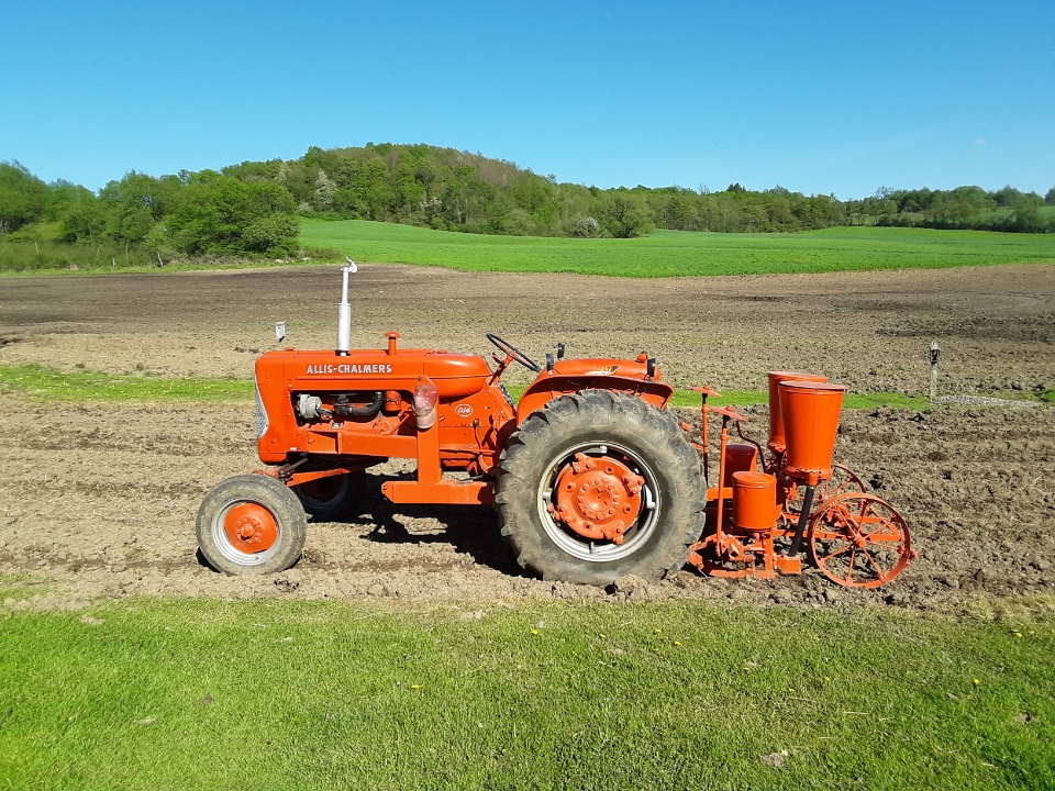

does anyone know how many links are supposed to b in the drive chain on this planter? I broke a link planting sweet corn , didn't have another but got it too work but wasn't planting rite only one side seemed to be dropping corn down. nothing was plugged.. just wondering if the chain might have caused any issues.. im not sure of the model number of the planter... thanks for any help
