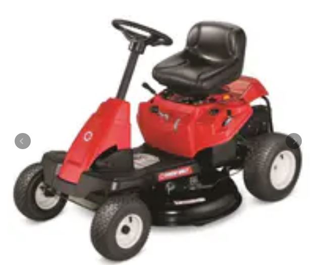

My Husqvarna has had the "BYPASS" for 18 years... I can figure out if I want the engine turned off when i get off the seat.. Dont need THEIR input ....
Wife has a smal1 10 HP 30 inch step thru that i took the deck off and she uses as a scooter around the neighborhood.. It had a switch that HAD to be plugged in to work.. Disconnect or bypass and it would not stay running !!  WHY ?? .. Could not figure it out, so i put a small plate over the button and wrapped duct tape around it to hold the switch DOWN all the time... been that way for 3 years.... fugure there must be a resistor or something inside the switch, besides the contacts ??
What on earth is a "step thru" ? I never heard that term in reference to mowers before.
Back when I was a kid, I knew what old women were talking about when they said "step-ins", but that had nothing to do with mowers. (for those not born long enough ago to understand the common language of Kentucky, "Step-ins" were what the modern girl calls "panties" )

Wife has trouble with knees and walking long distance.. I got her this little 30 inch step thru mower with a 10 HP Chink motor.. Leave it in 6th gear and Forward... Choke is on the throttle.... Push in clutch, crank, starts up and ready to go.. Never change gears, never backup .......... Kids call it "Grandmas 4 wheeler".  Had to bypass 3-4 different switches to get it to run.
Cheaper and 1/3 the size of a golf cart..... Gots a "TOTE" mounted behind the seat now to carry STUFF.

I have one of those "step through" mower bodies from the mid 1970's we use on a yard cart for sticks and such. 8hp B&S I rebuilt back in the early 1980's and the deck went to pot from rust. Runs and operates well but hasn't mowed grass in almost 40 years.
