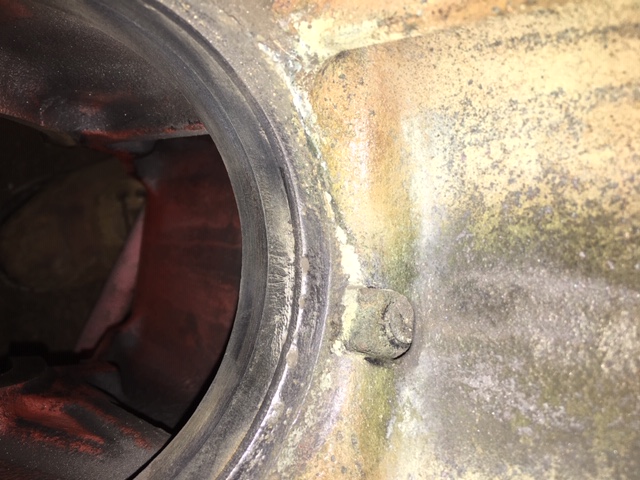

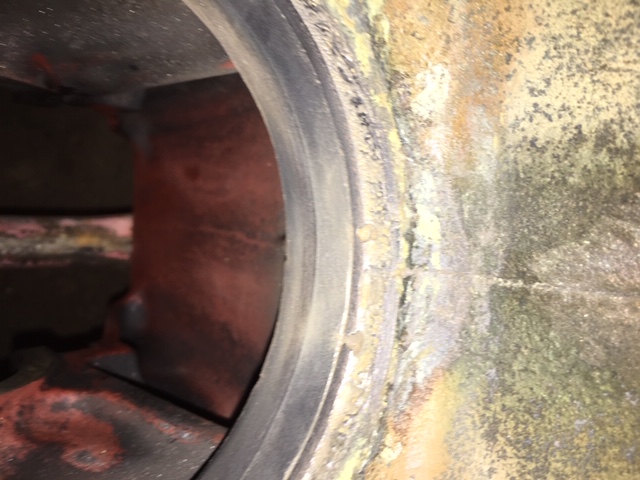

I think we r going to
1) use jb weld or some other epoxy to smooth up holes.
2) push in new sleeves and bolt down
3) pour one of the following items around sleeve and let set up.
Morosso or pioner or seal lock fluid weld. Leaning toward seallock fluidweld since the others are setting up awe fuel slow. Will try and post pictures of 2 worst holes

In the top picture, at top, it has eroded under top oring. Best to put third oring while it is apart.       MACK.
