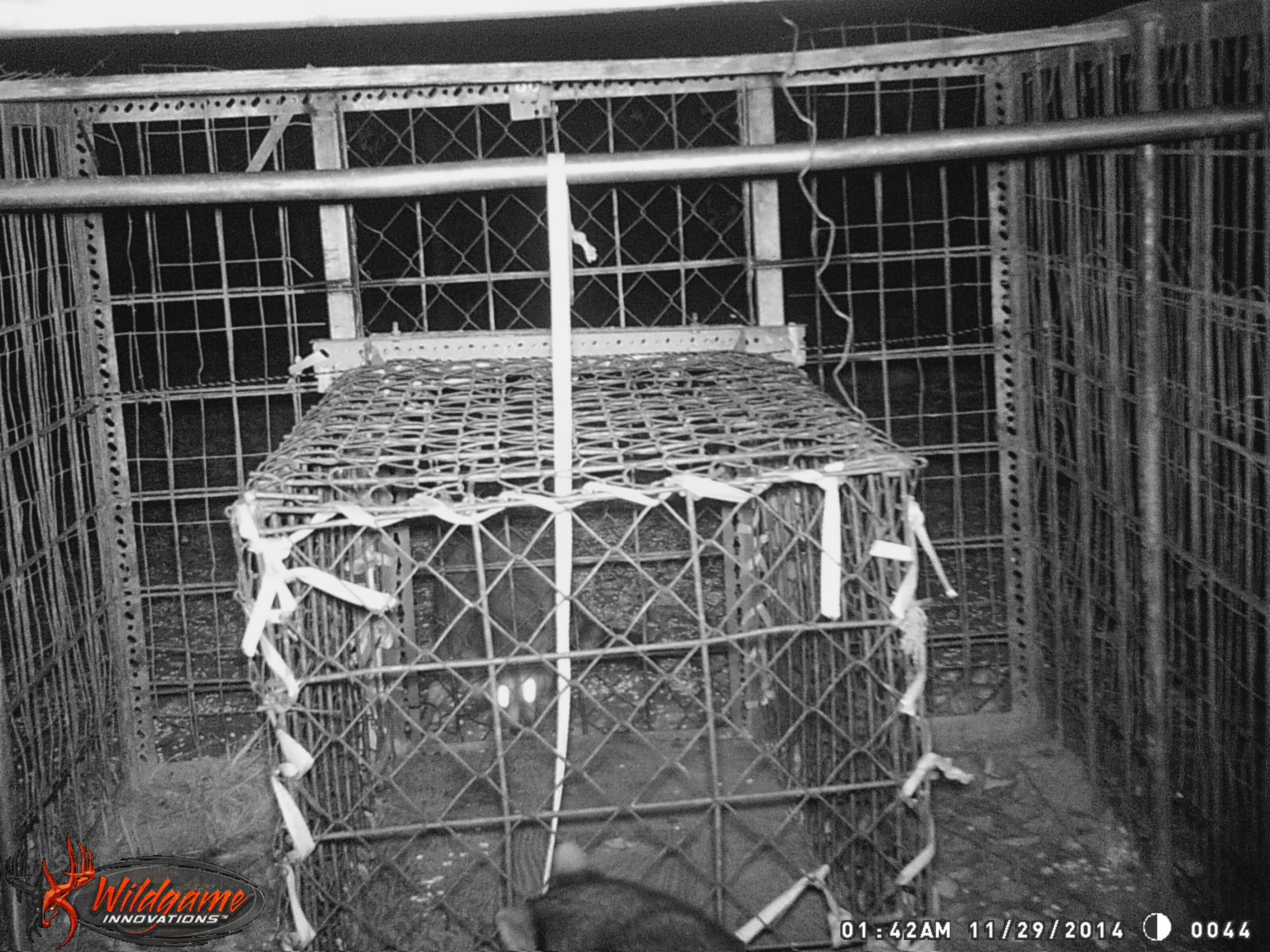

I built a nice portable Coon trap using Stock Panel frame Pieces covered with Chain Link Fencing. Top, Bottom, Sides and one end.  The Drop Gate Door is part of my 5x12 Hog trap. Made the same way as the Coon Trap. A Piece of Stock Panel covered with Chain Link fence. Just to look at it, it should hold any Coon That trips the gate.
   When the gate is closed there is a 1 1/4" X 24 opening between the top of the trap and the gate.   I never thought a coon could escape thru a 1 1/4" opening.  I know they can't get thru a chain link fence.
    I have no game cam set up so I'm just guessing the coons tripping the trap are getting out by squeezing thru the narrow 1 1/4" X 24 opening.  I have what I need to close the gap to 1/2 inch before my wife shuts off my supply of Bait.  Purina Cat Chow
    No full grown Coon should be able to squeeze thru a 1/2 crack. Even if his name is Houdini. Or Octopussy.

A rabbit can go thru a 1 2/4" gap, but big coon,---no way! Are they getting their feet around the door locks?--- I have had them reach around the latches on a very old live trap and get out! Make sure the latches are not reachable from the inside.-- Also if there are more than 1,--the ones still outside will help the trapped one get out! thanks; ac fleet

I closed the crack to less than a half inch.   I studied this trap from top to bottom . The largest way out anywhere are the holes in the chain link fencing. When the gate drops closed a spring loaded  hook at the top prevents opening of the drop gate until I manually unhook the catch at the top.   It would take a coon outside with plenty smarts to unhook the latch.  And.  The latch cannot be reached by any animal caught in the trap.
      I got a camera pointed at trap from the back.   We shall see in the morning everything that happens tonight.

The trap can and does catch Coons.  My game cam shows several frames of a very large Coon in the trap.  Also two more on the outside.  Somehow between the three of them they managed let the trapped coon escape.
       Only way out is lifting the drop gate just enough to let the trapped coon out.
     Time to redesign the locking mechanism that is supposed to prevent the gate being lifted even a little bit . Coons are very strong and extreamly resourseful when it comes to getting free

Look close and count the coons. One in the trap and two helpers on the outside.  Next frame 2 minutes later. No coons

Can you make a triple latch of some sort??---maybe a single with a PICK PROOF top cover.--Keeping it from being opened from outside is gonna be ruff!! thanks; ac fleet
