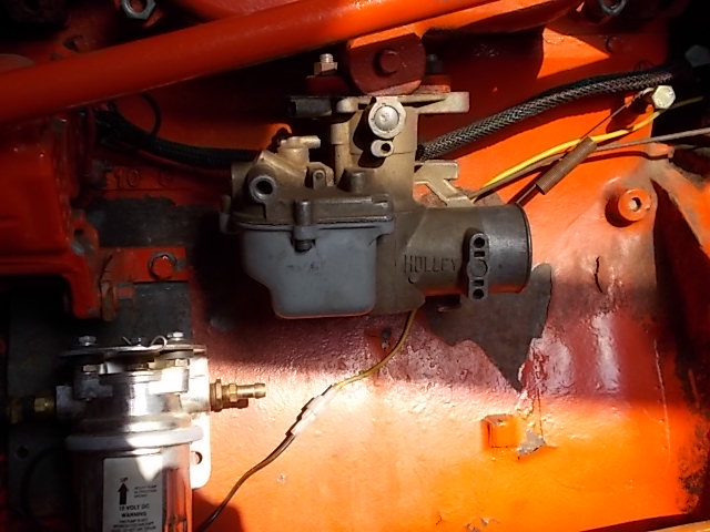

How about a Holly carburetor from a 190 on a CA?  I'd previously been using a worked over TSX869, It would die a bit on hard pulls. I found the Holley really allows more RPMs. after a little modification and drilling the idle jet a bit, it runs great on E85. I have the D14/15 manifold refitted to the CE head. To get the carburetor to bolt up I put aluminum studs in the carb flange and re-drilled it to match the manifold. I can maintain over 3000 RPM in 3rd gear at 2500 pounds, no matter how hard of a pull.

Post Options Post Options   Thanks (0) Thanks(0)   Quote DrAllis Quote  Post ReplyReply Direct Link To This Post Posted: 27 Jul 2016 at 1:38pm
I'm really glad someone found a use for one of those Holley brand carbs from a One-Ninety. I'll bet 90% of them got scrapped and replaced with a Bendix back in the day.
