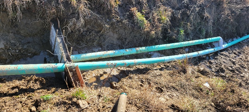

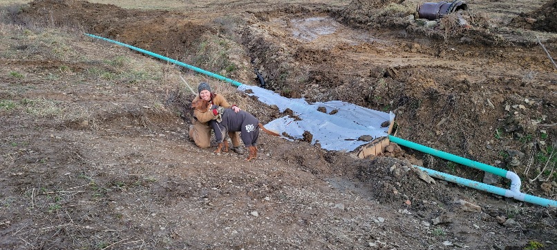

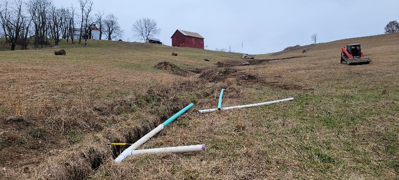

Here is my attempt to capture
spring watter.....
Spring development/water trough are not in place yet....
Any ideas on better capture techniques or on the trough itself please share... I have two more valleys to do similar.
Photos or diagrams please....
FYI: I have several spring outcroppings in this long valley but as summer goes along all but the bottom one dries up.
That is the reason for the daisy chain piping....

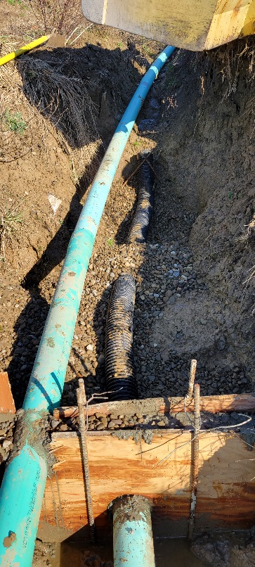

I made concrete dams bellow the spring outcroppings. Perforated pipe above the dam with gravel then plastic dirt shield over that prior to covering with dirt.
Solid pipe out the bottom of the dam ....

Some of the areas with springs I am just trying to dry up for farming.... that seems to be an easy task with perforated pipe in gravel.
However
The photos above are of one of the areas I am trying to capture the water....
If I used perforated pipe and gravel for the entire run , some water would migrate into the pipe and some areas it would filter out of the pipe. Leave less water at the pipe exit..
