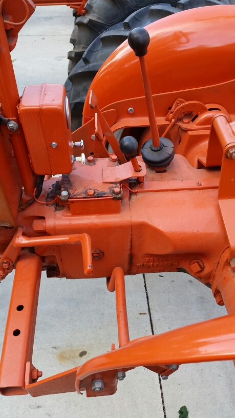

This was in a C.
B,C,CA,(2)WC's,(4)WD's,(2) WD45'S, 45Diesel, (2)D12'S Series 2, D12 Hiclear,(2)D12 Series 3, HD3, D17NF (3)D17 Series 4 Diesels, M-100 Grader,8550,A few Lawn tractors lots of other AC stuff
