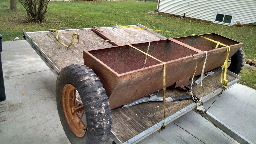

We throw a ton of lime on the food plot every other year by hand. Standing on a trailer flinging bags out the back being pulled by a Gator driven by an 8 year old with a twitchy throttle foot has run its course.
Time to upgrade. Bit the bullet and bought this for $25.
There is really old green paint on the body and yellow wheels so maybe (gulp) JD?
Funny how there is no braces from the tongue to each end, no levers or mechanisms whatsoever. Who knows how old this thing is, and what has been done to it over the years.
The augers have been cut out of it. I was told they cut the augers out and used it as a feed trough for cattle. Good idea I suppose, you work with what you have, right?

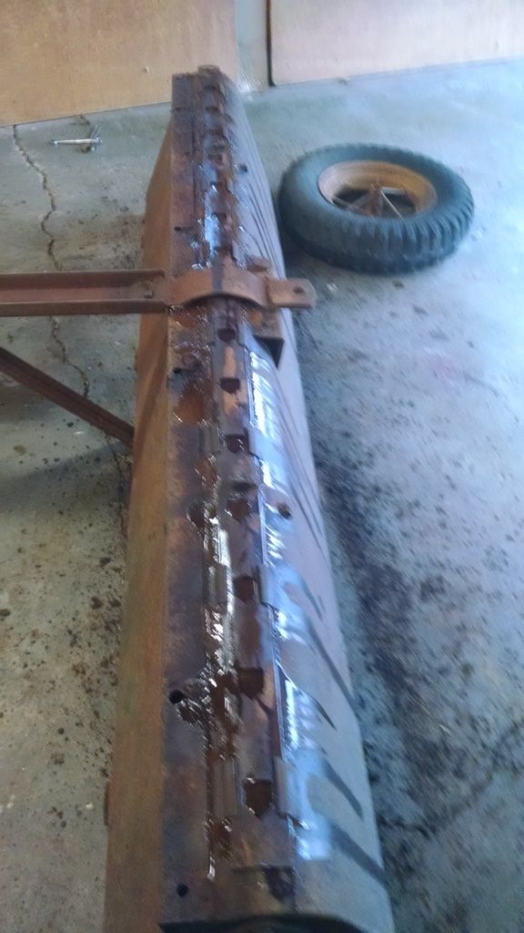

So, I can resurrect this. Flipped it over, pried all the metal tabs up a smidge, and pulled the wheels. A little homebrew penetrant and a hammer took the slides out pretty easy. A little wire brush and some 90 weight and they went back in pretty good, and work very smoothly. Tightened the tabs back up so the slides don't flop around.
Took it in the back yard, flipped it up, took the wheels back off, and took the remaining axle stubs out. These are direct drive. It looks like the shafts (about 1 1/4" diameter) ran from the wheels all the way to the center bearing. The center bearing is gone as well, but looks pretty easy to fab something up.
Now to build some custom augers this winter....

kinda sorta looks new ideaish, but need a look at the axle stubs, on the ends where the wheels go...
Also, if it was a new idea EZ flow, pop a pic of the setting plate, its rather distinctive...

Found quite a few Ezee Flows on the internet, they usually have disconnects at the wheels?
You can see the holes in the second picture, I would call them a square that tapers to a point?
The wheels just go on the shaft that goes all the way to the middle of the spreader. And pin on to the shaft with a bolt. There is one piece of auger left on one of the stub shafts, the auger must have measured 6 3/4" or so at one time...
