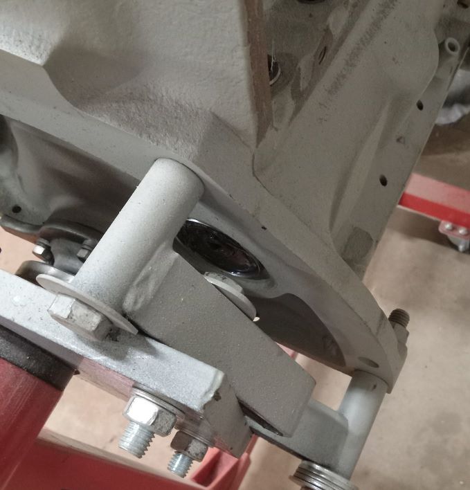

I am rebuilding the engine for my WD.
During the disassembly process I did not keep track of the existing camshaft plug located at the end of the camshaft. Now, I am not able to find a new one to replace the old one.
I have searched several vendors and either I am over-looking, or not available.
What are others doing for replacements?
Thanks
KC

Common item at almost any auto parts store, just take the measurement of the diameter of the hole, and remember whether it looks like this ( or  this ]...

Same plug from a 1934 WC to the 1975 model 175. An AGCO dealership. P/N 70910011.  It cannot be flat. It is shaped like a disc blade.

Got one from the local AGCO dealer when I did the engine for my 45. I believe they are a 'welch' plug.

According to the Allis-Chalmers "Numerical Index for Standard Parts" , this is an Expansion Plug,  2-1/2" Nominal Diameter.
That should make it easy to find at any auto parts store.
This is the concave style, not the cup style.
