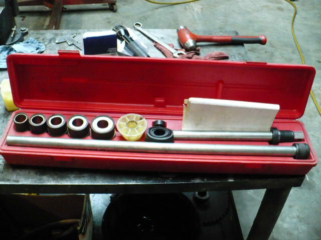

You can take the block to the machine shop, engine re-builder or maybe the local parts store will rent one like this one, it expands tight in the bearing and keeps the bearing from warping as it's pressed in place. Please look at the pics before you replace your bearing.

I have the same kit Don has shown above, and it works great.  Yeah it's a bit pricey, but you don't screw up bearings if you use it properly.

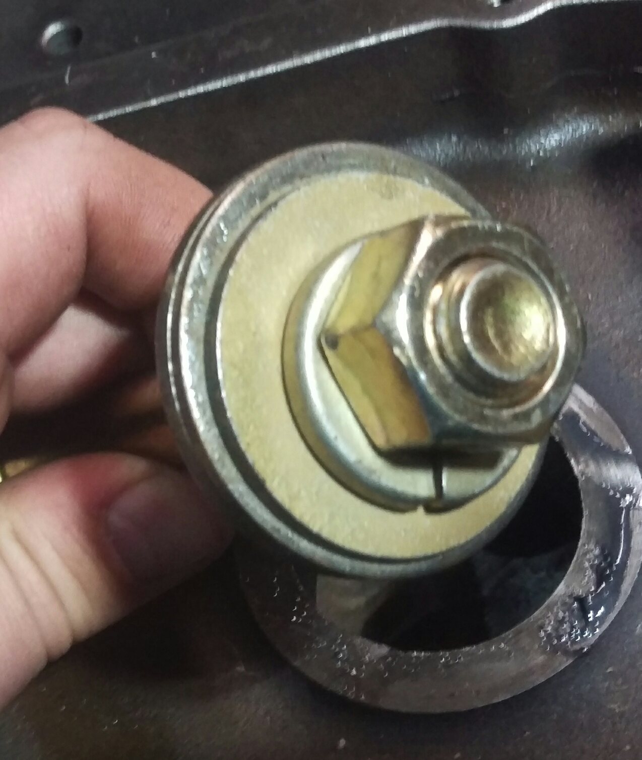

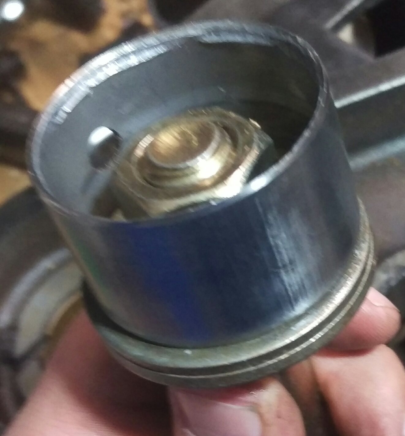

I read this post too late and destroyed my first set of Cam bushings on my Allis Chalmers D14. (149 engine) I made this tool afterwards and it works great... about $5 to make from tractor supply. I lightly tapped them in. Maybe could press them in also using this tool.. The washers fit perfectly in the bushings.

This is a picture of it on the used bushing.
