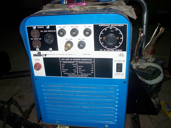

Miller Aead 200 LE and apparently you use it as much as I use mine.
I have used it for a generator but that’s been a few years back.

Post Options Post Options   Thanks (0) Thanks(0)   Quote desertjoe Quote  Post ReplyReply Direct Link To This Post Posted: 13 Jul 2019 at 8:13am
 Dang,,but you gots you a dang good memory,,THad,,I kept thinkin on thet welder so I had to go take a look see and you are exactly right it an AEA 200LE and still looks like i left it,,,what,,2-3 years,,??Wink I'ma gonna move a bunch of chit to get it out,,check the engine and get it runnin. One of the ta'ars is blown so got to fix that and put it on the MarketPlace for sale or trade for a 220 volt Miller mig. What you think a good sellin price for this "vintage" welder,,,,,,LOL  Ordinarily,,,,I dislike that word when I'm buyin,,,,,but,,,,??Clap I did find a brand new faceplate,,,looks nice,,,huh?

I don’t know on the value but I traded a Lincoln weldonpower 200
Rope start AC only for a $ 750.00 Ruger. It wasn’t near the welder you have. I’d really search out a Mm 200. They quit making them and soon the welders all started complaining so they made the MillerMatic Vintage which is what I have. It’s awesome but still not the welder the original 200 is. If you can test a capacitor or change out an electric motor you can make a MM 200 last forever. No boards or BS to mess with and the most crisp arm of all Migs

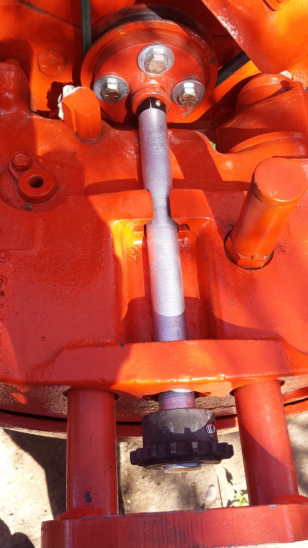

 Here's a picture of the drive assembly to the discbine's cutter bar...
The drive hubs, there are three and this one pictured is the worse with worn splines... $90 bucks each... then the drive shaft, some worn splines, JD price on it is $136 bucks... and then there's the hexagon drive pucks with the 6 holes in them, They are $146 dollars and 4 cents...  4 cents? Yup, thats what the feller said,  JD's that proud of them rubber pucks.  Well anyways, with all the good advice on how to weld things, ole Joe will be an xpurt in welding these rubber hexagon pucks... I 'll get them in the mail to you a couple dayz after tomorrow Joe...  an when your finished with them, I expect them to look like brand spankin new... Wink      LOL

   Hey JC,,,I woluld tend to say,,you gots you some pretty good service outa them tractor parts,,,,,but,,,but,, they can ALL be fixed. AND was I to have me a great reliable welder,,,,,I could,,,,,,,UMMmmmm
 Don't know if you remember,, way back when I was in the rebuilding of the D14 Industrial, I had a similar dilema of high priced parts with low amount of dollars. The splines of  drive shaft and the hub for the front pump had wore each other out and cost of the shaft and hub was gonna be lots of dollars,,,so my engineerin mind went to work and I come up on a fix that still looks and operates like the day I done it,,,,,Clap
 What I done was while in O'relly's,,I seen what was a 1" drive impact socket and a i" drive impact extension,,,,, The both pieces were only $20 and the socket was almost an exact fit in the center of the hub where the wore out splines were,,,,,Clap SO, I machined the center of the hub out to where the female part of the impact socket would fit in there just so,,,and put one of my "special" super duper welds on it to last forever,,!! I had a piece of 1" reciprocating pump shaft that was just the length of the needed shaft,,so I welded the male end of the impact extension to the driveshaft and PRESTO a drive shaft and hub arrangement that will outlive me and two-three others. The impact socket and extension are work hardened to outlive all that pounding back and forth so I feel sure they will work out just fine.

Points: 25247
Post Options Post Options   Thanks (0) Thanks(0)   Quote jaybmiller Quote  Post ReplyReply Direct Link To This Post Posted: 18 Jul 2019 at 6:06am
Hay DJ
Is that a factory or 'DJ special' fill/vent cap for the steering bolster?
yeesh, Grade 8 bolts to attach the adapter ! Kinda 'overkill'.......lol

Post Options Post Options   Thanks (0) Thanks(0)   Quote desertjoe Quote  Post ReplyReply Direct Link To This Post Posted: 18 Jul 2019 at 8:42am
 Well,,,Jay,,put it this way,,,that one was on the tractor when I drug it out the weeds to get it home,,,, I did add a tack weld as the top part kept wantin to fall off.  When I build something,,I build it to last,,,ME, Clap
