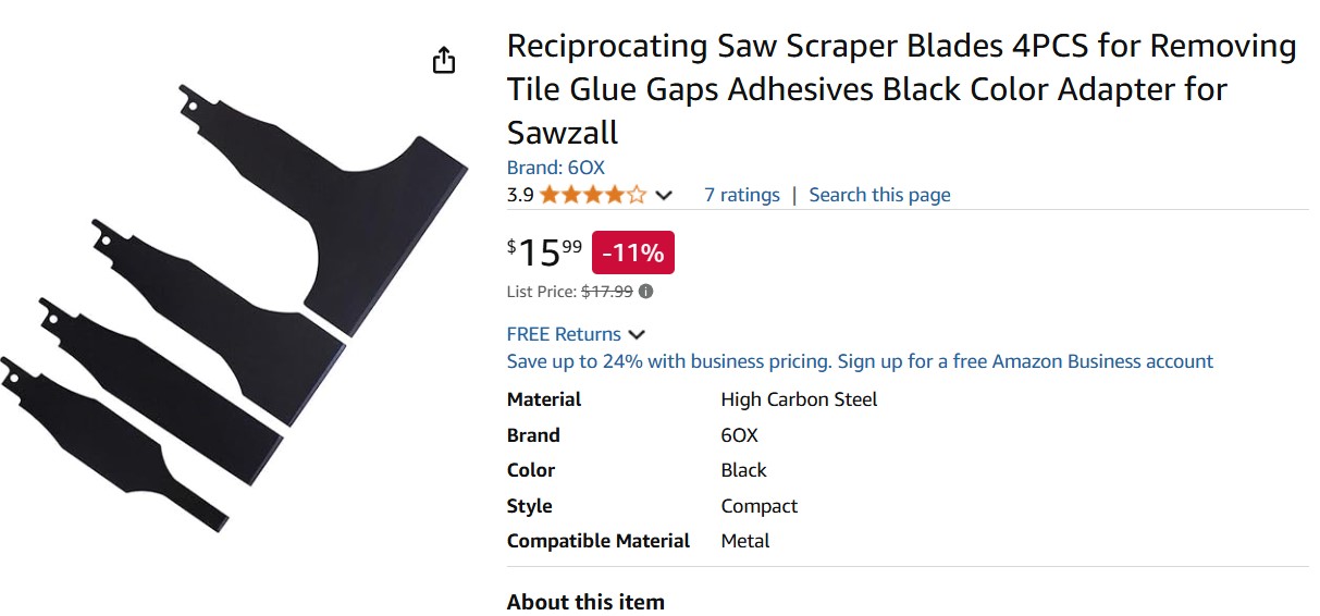

Post Options Post Options   Thanks (0) Thanks(0)   Quote Pat the Plumber CIL Quote  Post ReplyReply Direct Link To This Post Posted: 13 Feb 2025 at 8:58pm
Spyder a brand of drill bits,saw blades makes a flat chisel blade that fits in the end of a Sawzall. On a jobsite a while ago a couple guys were doing just what you described

Post Options Post Options   Thanks (0) Thanks(0)   Quote steve(ill) Quote  Post ReplyReply Direct Link To This Post Posted: 13 Feb 2025 at 10:00pm
i had never heard of that Pat... I made something similar to use in an air powered chisle gun years ago... I will remember this !
