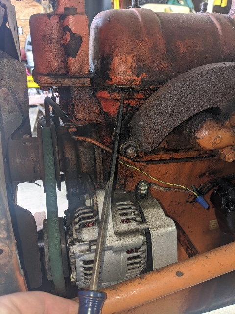

In my next course of action 2 swap my front end out that is a narrow front to a wide front I also found the leak that looks to be the gasket over the valve cover where the screwdriver is pointing there's a crack about an eighth of an inch wide that the oils coming from. I can't seem to get this cover off oh, what does it take? (It seems like there are rubber washers on top of the four bolts that hold the valve cover down that maybe holding up the cover from coming off)
Dave(inMA) View Drop Down
Location: Grafton, MA
Points: 2399
Post Options Post Options   Thanks (0) Thanks(0)   Quote Dave(inMA) Quote  Post ReplyReply Direct Link To This Post Posted: 05 Apr 2020 at 2:35pm
The valve cover is likely sealed to the gasket which is sealed to the head. The rubber washers will come off with some gentle persuasion.  As to the valve cover....find a spot where the bottom edge of the cover doesn't extend down over the gasket. I think you have a spot right in front. Carefully drive a putty knife through the gasket - between the head and the cover. You can then carefully pry the cover loose by working both directions from that corner. You'll need a new gasket.

Post Options Post Options   Thanks (0) Thanks(0)   Quote Hunt4Allis Quote  Post ReplyReply Direct Link To This Post Posted: 05 Apr 2020 at 2:47pm
Yep I was trying all that but it did not want to come off. I left it alone because in my experience when I try to force something that's when it will break so I didn't want to get that far and mess something up if I was missing something else holding it on...

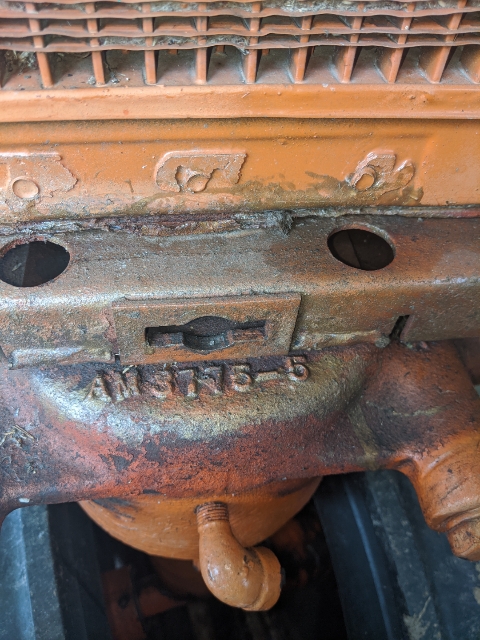

Can anyone confirm that the front bolster that is required for the wide front end is the casting number in my picture?
Dakota Dave View Drop Down
Location: ND
Points: 3973
Post Options Post Options   Thanks (0) Thanks(0)   Quote Dakota Dave Quote  Post ReplyReply Direct Link To This Post Posted: 06 Apr 2020 at 10:48am
your good.
Hunt4Allis View Drop Down
Joined: 13 Mar 2018
Location: Ohio
Points: 1172
Post Options Post Options   Thanks (0) Thanks(0)   Quote Hunt4Allis Quote  Post ReplyReply Direct Link To This Post Posted: 06 Apr 2020 at 11:19am
That's weird because it's on my tractor right now that has a narrow front end on it?
