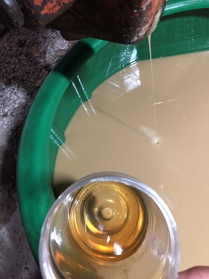

I checked the foot clutch disengagement per CTucker's instructions. Seems fine. Drained the tranny fluid and found this:
The plastic jar has some HyTran right from the container for comparison. So clearly the tranny/differential had some water in it. I saw a little of the milky brown goop when I drained the differential (via a axle housing bolt hole) when working on the hand clutch and brakes. SHOULD have drained the tranny right then and there, but the chunky wood blocks supporting the tractor were in the way. Not much of an excuse, but I have learned a good lesson.
I'm letting the tranny drip until it stops, hoping to get all the water out of it. Is the drain plug truly at the low point in the tranny? I'll drain the pto pump next.
Wonder how much of my shifting problem is due to the contaminated HyTran?
Dave
p.s. My drain pan looks really clean as I had planned to re-use the HyTran....not any more!
Edited by Dave(inMA) - 26 Apr 2019 at 3:09pm

3. Reinstalled all the extraneous bits, added HyTran, double checked the drain plugs and fired her up. I was able to shift into all 5 gears, some more easily than others.
4. Ran it up the road and back in 4th - a little over a mile total. Still able to shift into all gears.
I appreciate all the suggestions/guidance on this one. Fortunately and happily, it's got a good ending. Another victory for the Forum! Big smile
Dave
