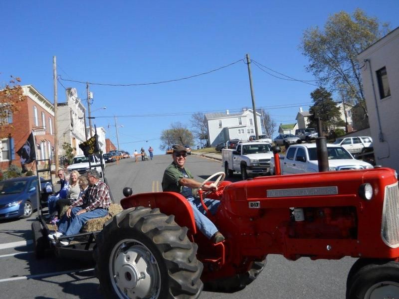

I used my D17 to haul people at an event. I placed a row of hay bales down the center of my 16' trailer and a strap long ways for people to hold on.
Loaded with people I was glad on some of the hills that I did not have to stop or it would have been touchy. I did not have trailer brakes hooked up.
Charlie

Post Options Post Options   Thanks (0) Thanks(0)   Quote Charlie175 Quote  Post ReplyReply Direct Link To This Post Posted: 29 Sep 2016 at 5:16am
I found a picture
Charlie
