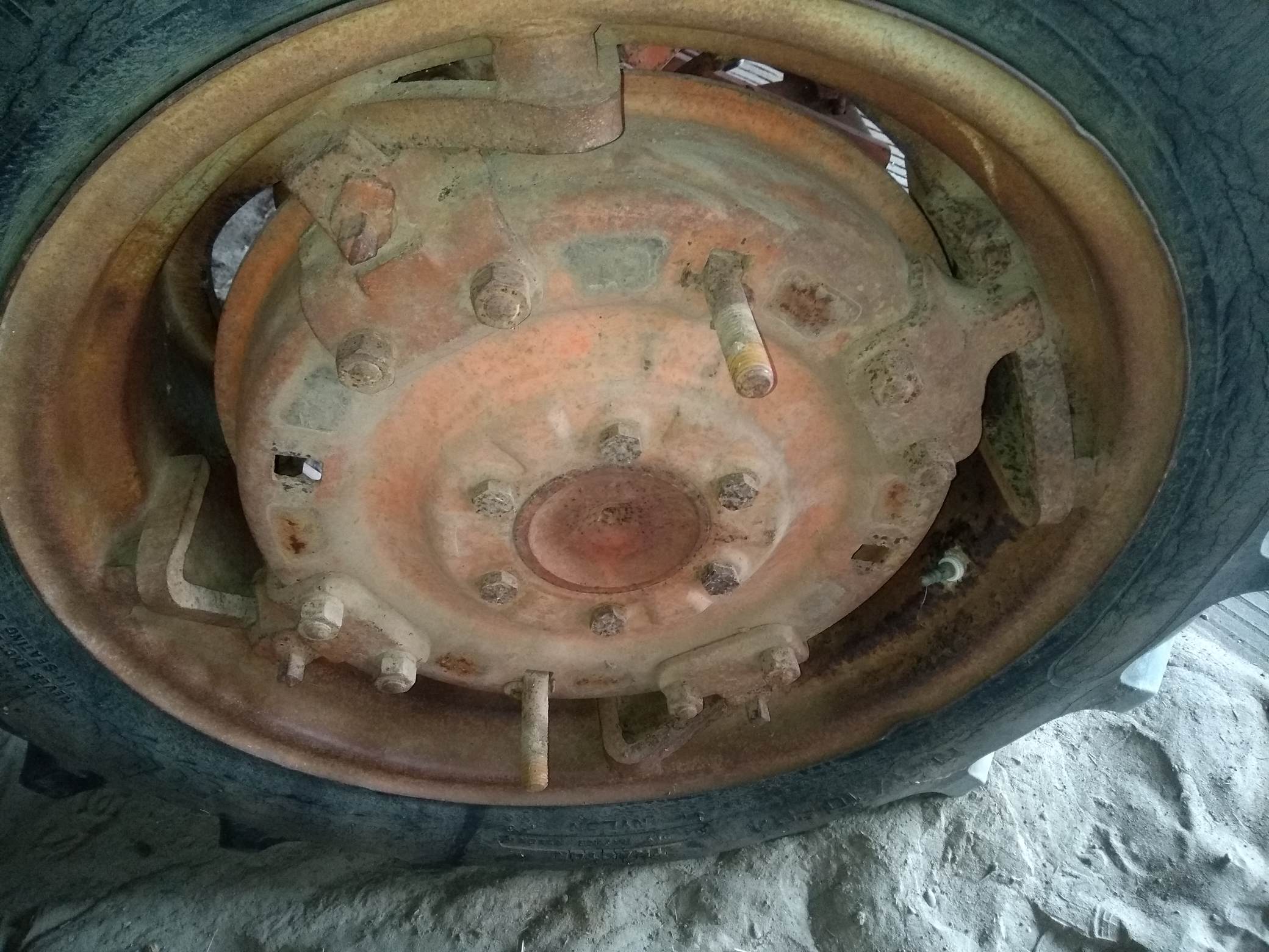

Working on restoring a 1950 CA.  Need a couple parts, hope someone can help.
Rims:  10x24 4 Rail.  Several vendors have them, most priced in the $450-$700 range.  There is a place in Bourbon Indiana, sort of near me so I wouldn't pay shipping, JC's Farm and Garden Supply, listed in Old Allis News, for only $326.  Anybody ever bought from them?  Seems odd that they'd be less than half price from Steiner's or DJ's.  Like the price but not if they're cheap or won't hold up.
Also, three of the four CA's rail clamps are the same as a WD or WD45, but one is different.  Part number 70225188.  Anyone know where I could find a couple of those?  Google is not my friend for that one.
Thanks in Advance.

CA’s have only 3 clamps per side with 1 hanger clamp and the CA clamp bolts are square heads. W series have 4 clamps and the clamp bolts are hex heads.

x2.  Clamps are not the same as those used on the WD or WD45.

I guess I'll say that 70225188 is just the clamp shell/housing and doesn't include the innards.
This part is the Guide Rail Body only.  It has NO hole for an eccentric pin.  It just holds the rim onto the wheel to help you get the rim on.
Do you have FOUR (4) clamps holding the rim onto the wheel?  Then you don't need anything.
As stated, the wheel and rim needs three (3) eccentrics (70220756) and one (1) GUIDE (70225188).  Also you need 3 of the BLOCK for Eccentric Pin, Rim Locking (70220032).
Do your eccentric pins have square heads or are they hexagons?  The square heads are made for the CA, but either will work.
