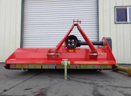

Can you add enough remotes to operate a smallish side flail mower to a CA?  What would that entail?

What "side mount" are you looking at ?  Hydraulic drive ?  Not enough pump..... My first question is what are you going to BOLT it to ?  Need some type of frame under the tractor.... Then, they are PTO driven , so you need a shaft to the rear end and belt drive off the PTO ???
Most of the side drives have a RAISE- LOWER... and  SHIFT FWD or IN-OUT.. So you would need two sets of hydraulics.. that could be done, but would take a NEW double valve working off the present hydraulic pump / hose.
If you had a REAR MOUNT... it runs directly off the PTO shaft and you just need a single acting cylinder to LIFT up and FLOAT down .. ??

Following 3pt mod.  3pt for lift, plus simultaneous left right extend/retract and tilt.  Something like :  https://betstco.com/product/fh-efg155/?gclid=Cj0KCQjw4NujBhC5ARIsAF4Iv6fecaHUNFGH6zSAjeXHEWyLxTV88_ldnZPZXx6nxMFV8ar79uxsa30aAjLpEALw_wcB  ;
Seems like lift would be fine with single acting (with mod).

YES... you need some type of 3 point or modified rear lift system.. Power UP and FLOAT down would be OK... You dont need any extra hydraulics other than what is already on the CA... That one has a MANUAL adjustment for side shift.. You set it and it stays at that point.....
That would be your best bet. Some type of 3 point to lift, and no hydraulic side shift... If the one you get has a side shift cylinder, then PIN it in one position ... make it manual adjust.

I was also looking at hydraulic offset such as:
I'm trying to decide on what is the best decision for adding remotes in the future.  Quantity and type.

HP should be OK ... Weight is 650 pounds... thats about the same as a 6 ft 3 pt disc.. You might need 100# weight on the front end to help.... Bouncing can be a problem..  if front end does that, you could overload the torque tube.. Some with loaders have broken the tube.
It's disk is 8' wheeled with single raise cylinder (if I get it repaired).  This would probably be the heaviest implement if I decided to get it, but I may just opt for a 5' brush hog.  Dad has a 6' but it is too big even for the farmalls.  Stripped the gears out of the smaller one.  But either way, I want to increase the hydraulics support.  Adding fluid, wheel weights, and side weights shouldn't be a problem (if I can find side weights at a reasonable cost).
That 650lbs would be a lot closer to the tractor than a disc.  Much less lever arm.

Here's a 60 inch with a D10, similar weight only couple more horsepower.  Obviously a little underpowered, but otherwise seems to handle it ok (with loader on front):
