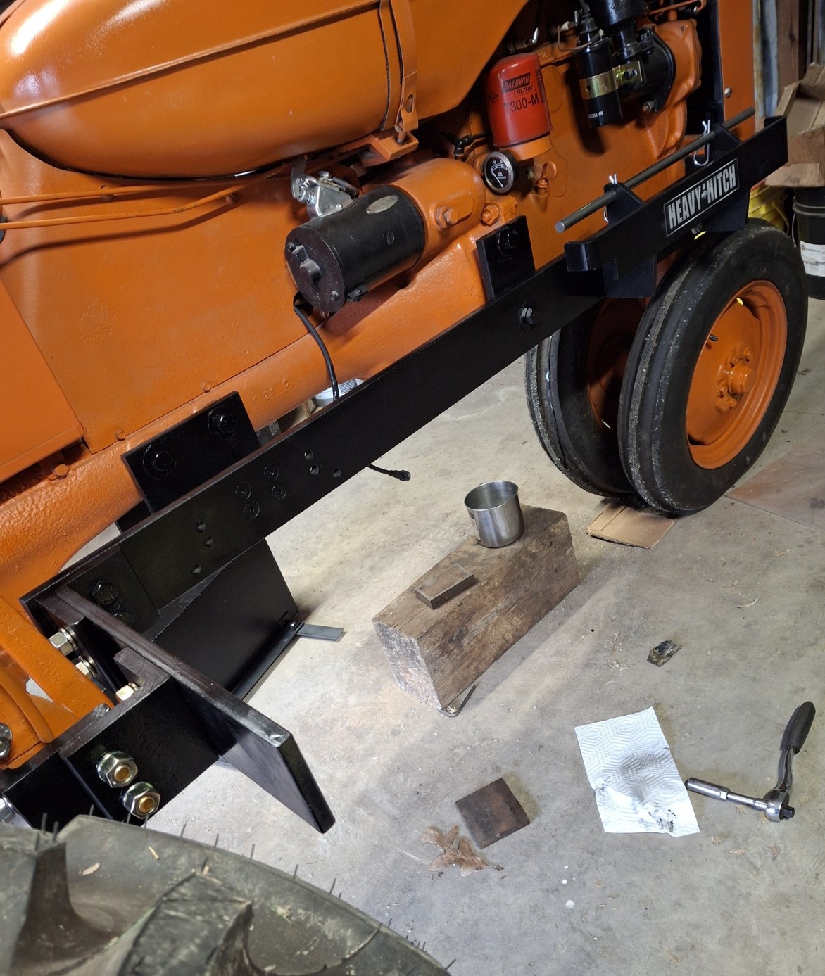

My original plan was to use 5 x 2 or 5 x 3 rectangular tubing, but I was unable to get it locally (at least quickly). It's still an option for reinforcement.
Edit: I was surprised at how nice and square everything fit together. When I clamped the vertical risers to the cultivator bracket, they met almost perfectly flat and inline with the other side. The reinforced angle brackets mating the side rails to the top were preformed items I bought off the internet. I've used those on the side rails in places also, except those were slotted and these I had to drill. There was almost no distortion caused by tightening all those bolts at the top. Of course it all started with the guy that welded my bail together. I stressed to him how important it was to be perfectly square. Edited by dfwallis - 06 Aug 2025 at 3:45pm |

I don't really like what I've done, but there was just not a lot of good options. The supplemental bail mounts to the cultivator bracket position. This gives me pretty good vertical support on the axle (but of course requires the wheels spun out just a bit, which I don't mind because it's a tiny bit more stable). I left a vertical protrusion on purpose while I was deciding whether to add a canopy/ROPS. So the vertical frame supports for the canopy are attached to this vertical protrusion above the cultivator bracket. So as to not further limit how far in I could bring the tires, I mounted the supports on the inside toward the fenders. This then limited the thickness that I had intended to use to gain ROPS strength. The thickness I wanted worked on one side but not the other, perhaps bent fenders (didn't bother to see where it was off). For now, I use clamps (half inch plates with 4 half inch bolts) with a single 3/4 through pin with an R clip. It is rock solid. You can pick the tractor up with it with zero deflection, zero rotation. I used 3/4 x 4 inch flats for ease of fitment. I could easily add some square tubing to the outside of each rail to improve the side to side bending resistance, again at the cost of limits on tire adjustment range. All because i didn't want to mod the platform. I guess I could have bought another platform and modified it like I did for the PTO guard, but then again, there's not many other good locations to bolt onto other than giant clamps around the axle (like the H and M use). Edit: Those rails are pretty darn heavy. I may not be able to lift them into place in a another few years :( ![]() ![]() Edited by dfwallis - 04 Aug 2025 at 8:42pm |
1952 CA13092
DSpears N IL ![]() Silver Level Access ![]() ![]() Joined: 11 Sep 2009 Location: Rockford,Ill Points: 415 |
can you share some pictures of the canopy mounting to the outside of the fenders?
The uprights look to be good for the canopy to hold. Thanks Dewayne |

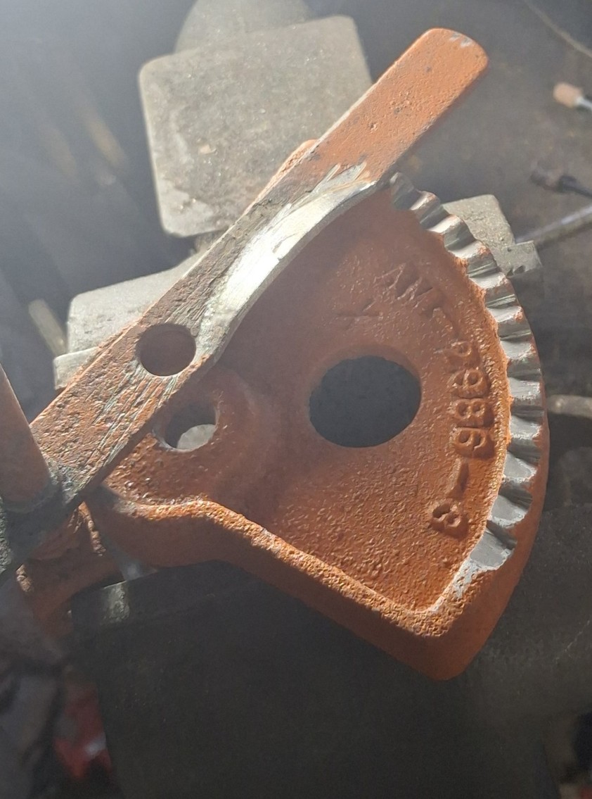

I worked on the wedge pins to clean them up and paint them. Wire brushed, sanded, wire brushed, and soaked (washed in dish soap a few times too). I left a few specs of original paint on for character :). I didn't spend much time on the chain since it's a spare. I just coated with primer for safekeeping. If anybody might need one, I might part with it. I believe it is in pretty good shape with 12 links:
![]() I only soaked them for about 4 hours. I'm not sure if the WD40 version is the same as Evaporust or not. Seems similar in performance. ![]() Painted the wedges and the SAE-B hydraulic pump mount. I noticed a few missed spots and took it back out to touch them up after the pic. Was too dark in the garage when I painted. The mount is aluminum. The paint will probably interfere with pump mounting. I'll fix that later if needed. ![]() My workshop in TX is typically slightly more toasty than the one in IN. After I turned on some fans to bring in outside air it went "down"...to 106 :( As long as a fan is blowing directly on me, not too bad. ![]() |

![]() ![]() It is Not Rollover approved, but worked well for my lawn maintenance applications!

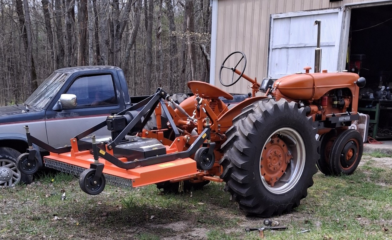

First use after 30+ years was to mow a small field with a finish mower at the highest cut setting. It did fairly well. Two videos are posted at: https://www.youtube.com/@OrangeAcres-h2k One shows the tractor state as of March of 2023. The other shows the tractor in use mowing this field. I didn't start recording until after the field was mowed and I was going back over chopping the "wind rows" and missed sprigs. This was 3 feet tall in spots. ![]() Edited by dfwallis - 28 May 2025 at 11:24am |

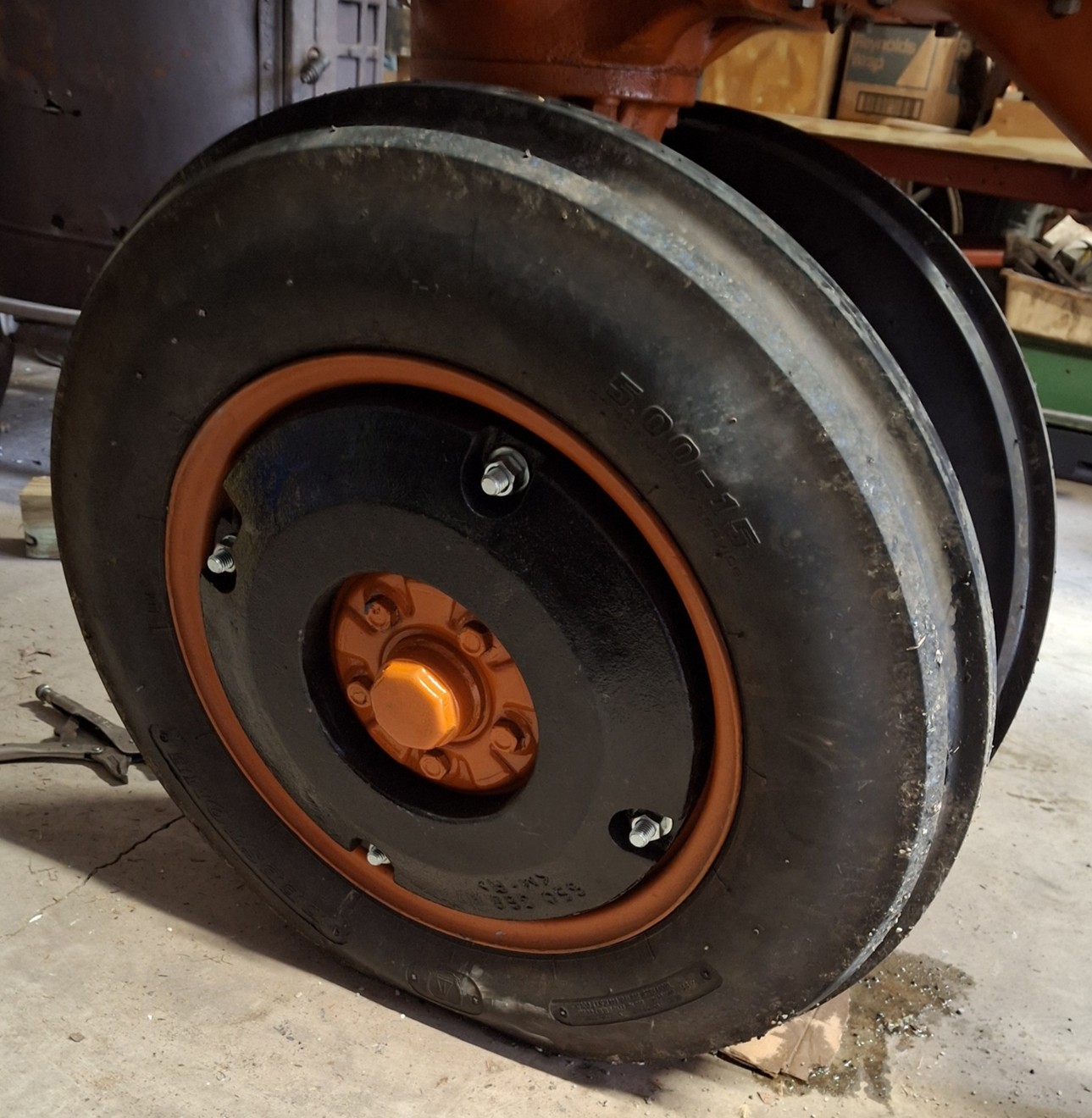

Tires balanced. It took 15oz for the left front tire and 20oz for the right front tire. This dramatically improved/eliminated the wild oscillations in 4th gear. I was disappointed in the tire shops I called pooh poohing balancing these tires. Both rims show to be bent but they are very large gradual bends all but invisible unless you use a straight edge to compare with. The right side tire has a heavy weld in two spots where the rim was destroyed by a tire ballast leak in the 60s, but surprisingly, that was not where the imbalance was. I did have to grind the weld down a little in one spot to get the wheel weights (not the clip on balance weights) to center. ![]() ![]() Edited by dfwallis - 28 May 2025 at 11:11am |
