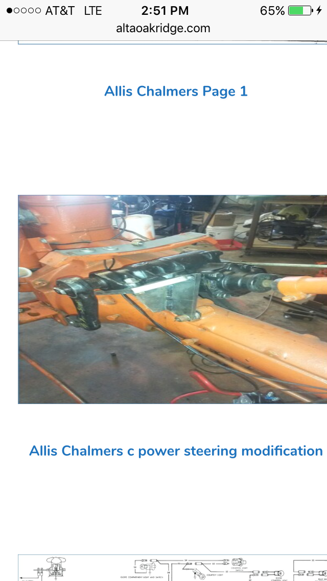

Some one posted pics a long time ago of a CA that had the torque generator inside the tool box under the fuel tank.

Post Options Post Options   Thanks (0) Thanks(0)   Quote Nathan (SD) Quote  Post ReplyReply Direct Link To This Post Posted: 06 Feb 2019 at 10:53pm
Another photo I found from a C.
