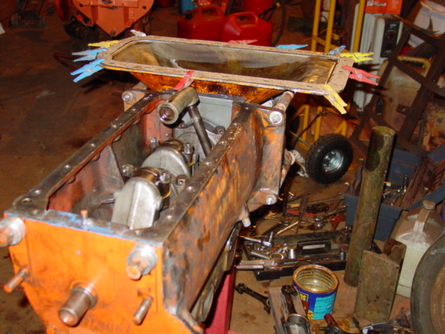

In replacing pan gaskets on all types of engines I have always glued the gasket to the pan and placed the pan on the block dry. The pan can then be removed without replacing the gasket. Care has to be taken in preparing the block surface to make sure no leaks will start where parts/covers bolt to the front and back of the block. Not wet sticky areas at the time the pan is bolted on.

Clean every trace of oil/grease off the pan and block sealing area with brake cleaner. If you look at Dick's pic, you'll see 4 joints. Put a small dab of RTV on each joint. More is NOT better here. The silicone RTV that smells like vinegar is a very poor choice here. Over time it will corrode metal surfaces, and it's greasy and will allow your gasket to squirm. The best stuff hands down is Ford TA31 or GM 88861417. These are both RTV and adhesive.
