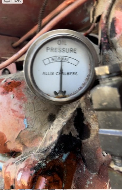

CA no oil pressure!
 Post Reply Post Reply Page  <1234 5>
84 prospector View Drop Down
Joined: 30 Aug 2022
Location: California
Points: 65
Post Options Post Options   Thanks (0) Thanks(0)   Quote 84 prospector Quote  Post ReplyReply Direct Link To This Post Posted: 31 Aug 2022 at 10:14pm
The tee that the gauge is connected to and the line coming from the filter on it is in a port on the side of the block. Where does the oil actually come out of the block from? The small tee with the small line that is connected to the filter? Or from the bigger tee on the side with the gauge and the bigger line?
Points: 88431
Post Options Post Options   Thanks (0) Thanks(0)   Quote steve(ill) Quote  Post ReplyReply Direct Link To This Post Posted: 31 Aug 2022 at 10:23pm
Look at my picture... the oil comes from the bell housing TEE into the bottom of the filter... about 15% of the oil is DUMPED TO SUMP thru that 1/2 inch hole in the side of the block.... You are dumping WAY TOO MUCH Oil back to the sump with that wrong filter..
Plug the  BIG STEEL PIPE out of the filter  and  put the gauge there... Eliminate the line INTO THE BLOCK...
Or just put the gauge on the curved steel tube going INTO the filter, and eliminate the filter / STEEL PIPE drain and all.
Edited by steve(ill) - 31 Aug 2022 at 10:28pm
Points: 88431
Post Options Post Options   Thanks (0) Thanks(0)   Quote steve(ill) Quote  Post ReplyReply Direct Link To This Post Posted: 31 Aug 2022 at 10:27pm
So just to be clear I can’t use the filter setup that is on it? Is the system now going to be starving it of oil?
Yes, that filter is 100% of your problem.

Ok now that makes sense, it’s just pushing All the oil straight through that filter because it’s not a bypass and back into the block. It will be safe to run it for a few days with the small oil line going to the filter blocked off with the gauge?

You can use this filter setup if you put in a restriction ahead of the filter.
I would suggest an orifice no bigger than 1/16" to start with.
Edited by Les Kerf - 01 Sep 2022 at 6:39am

as Les said, you need to restrict the oil flow thru the filter so that only 15% of the total goes that way.. The ORIGINAL filter does that internally with its cotton construction..An  auto filter has NO RESTRICTION so it wall pass MAX FLOW... An aftermarket filter could work if you had an orifice... If your restricting 10%- 15%- 20%... its not that important.. The idea is to maintain PRESSURE on the gauge and still have EXTRA oil that you can run thru the filter... You could use a needle valve and only crack it a turn open, then lock in place.... But if you want a clean, more original look ... go with the factory filter.

No... you would have no idea what amount to use... if you insist on using the auto type filter, plug up a fitting and drill a 1/16 - 1/8 inch hole in it........ Or use a valve like the fuel pet cock and restrict the flow ...........
Personally i would SCRAP the auto filter and use NOTHING if i was not going to install the original.
Did you cap the drain line and rerun the pressure test ???

Start with the 1/16. You can make a 1/16 hole 1/8, but not the other way. 1/8 will flow basically 4x the flow as 1/16, which in your case you’re trying to restrict that flow.

I bypassed the filter and have good pressure.

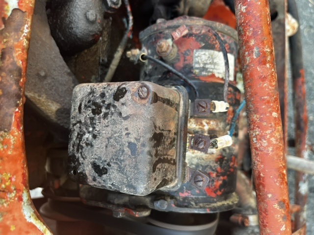

Points: 88431
Post Options Post Options   Thanks (0) Thanks(0)   Quote steve(ill) Quote  Post ReplyReply Direct Link To This Post Posted: 01 Sep 2022 at 9:10pm
voltage regulators look something like this... Clean the terminals and maybe you can see a letter on each.   Probably in this order anyway.
while running, if you GROUND the "F" terminal , you should see higher voltage at the "A" or "GEN" terminal .........if the regulator is working, you will see the charge at the "Bat" terminal also.
the system can be NEGATIVE or POSITIVE GROUND... From the Factory it was 6 v POSITIVE GROUND.

Radiator is cleaning up well, I looked at the letters on the voltage regulator and the middle one says batt, the right one with the red wire says F, and the one disconnected says L. Is it possible that this was converted to negative ground because the ammeter is reading “charge” while there is a load being put on the battery and it won’t go above 6.2. There is a sticker on the generator that has a local power supply shop name on it.
Points: 88431
Post Options Post Options   Thanks (0) Thanks(0)   Quote steve(ill) Quote  Post ReplyReply Direct Link To This Post Posted: 02 Sep 2022 at 7:42pm
"L" normally means LOAD and is hot like the BAT terminal when the tractor is running... On that type of regulator, the "G" or missing terminal might be on the BACK side ???
Look at your battery.. ONE terminal runs to the starter... the other is GROUNDED to the frame.. That will tell you if it is POS or NEG ground....
You need to test the generator without the regulator to see if it works.. Like i said, ground the "F" terminal ........ run a jumper wire from the  "A" terminal to the battery ( or starter) HOT lug... When the tractor is running,  measure the voltage between the  "A and F" terminals..   If the generator works, it should read around 7 volts... If you pull the wire off the A terminal and measure the generator output, it might go to 13-14 volts NON REGULATED... since it cant see the battery.
