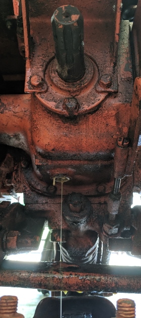

Here's where I removed drain plug from( seen from rear- directly in line with PTO shaft)
There seem to be a lot of plugs but this one was the one I could get to easiest, b/c of other metal members in way of other hex nuts that appear to be all drain plugs?not sure why so many drain plugs, but it seamed to do the trick...
What is the proper steps to the fill?( Do you fill up so far, then run hydraulic pump to prime it, then shut down and fill rest of the way or what's best method?( Never done this before)

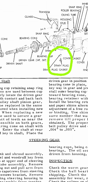

Ok, think I drained it via correct plug in picture here but this manual doesn't cover refilling procedure?

The rear diff gear box share oil. There is a hasket dam between the two just start filling when it tops the dam is starts running over and filling the hyd pto sump. When its full both haves are full the pump is self priming and has vwry little oil in it. From empty should be about 2 1/2 gallons

Matt, there's a plug on the pump too. So 3 places to draining from. You can get too it real easy. It's just to the right of your pic on the bottom of the pump itself. The plug on mine needed an Allen wrench. Would assume yours does too.
Just did what you are doing to my CA a few weeks ago. Drained it all and put on new hoses. When the pump plug was removed at first just a drop or two came out. Stuck my pinky tip as far as it would go and then a huge glob of......something....plooped out and it drained fully.
