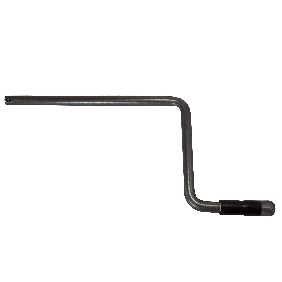

Where the heck do i store the hand crank ?  The WD has some nifty hooks on the fender, though I dont see those on the CA.  It also doesn't seem to fit to well in the tool box.

To securely store the hand crank, stand in front of the left rear wheel facing the steering gear. Hold the crank as in the following picture, with your right hand. Tip the left end of the crank down at approximately 45* angle and place it in behind the steering arm support.

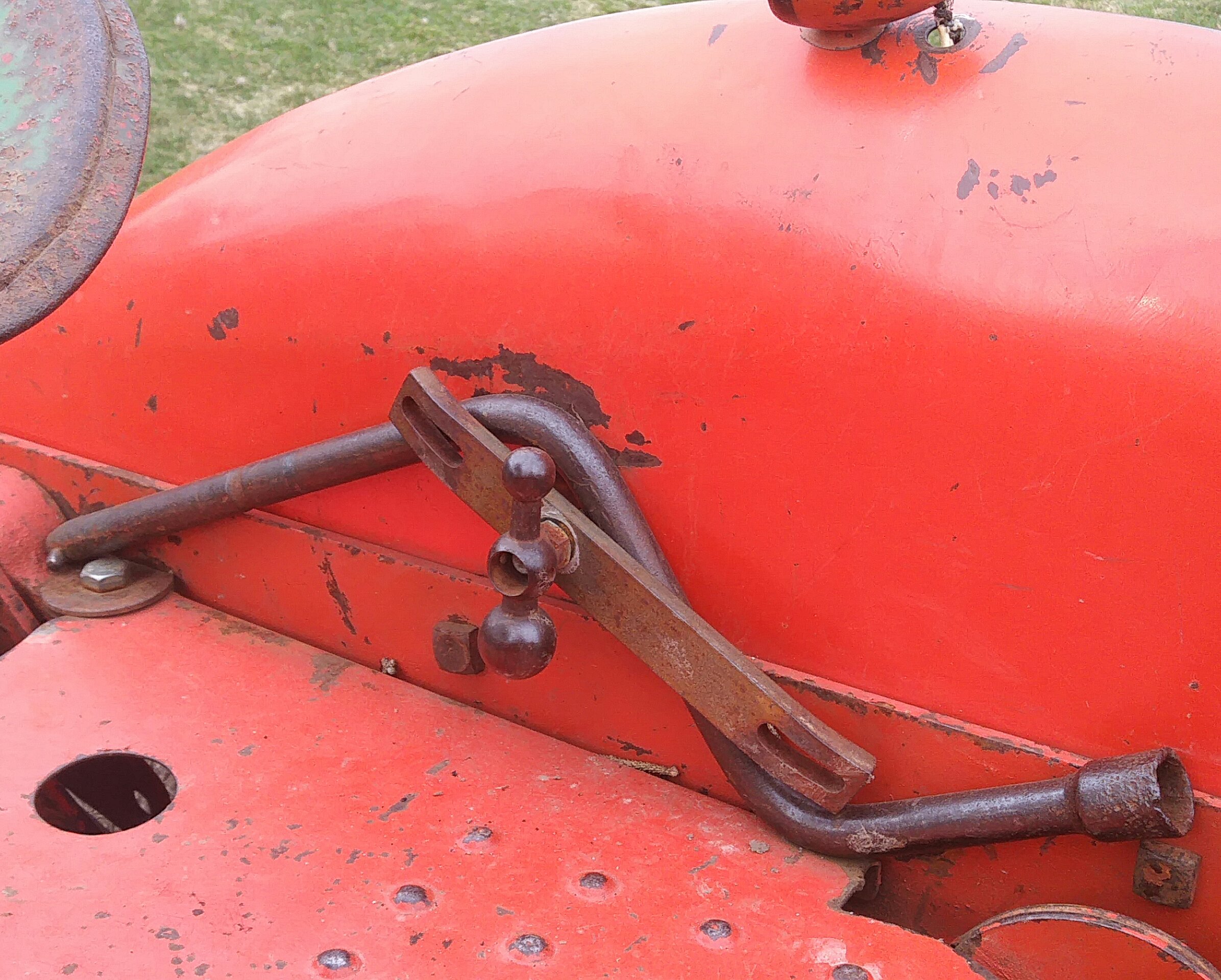

The crank for mine is stored screwed on the inside left fender with a cool screw thats weighted. Will see if I can get some pics.
This is where I carry my crank also. Never falls out.

Got the hand crank storage figured out !!! Followed your directions and BOOM fits like a champ.

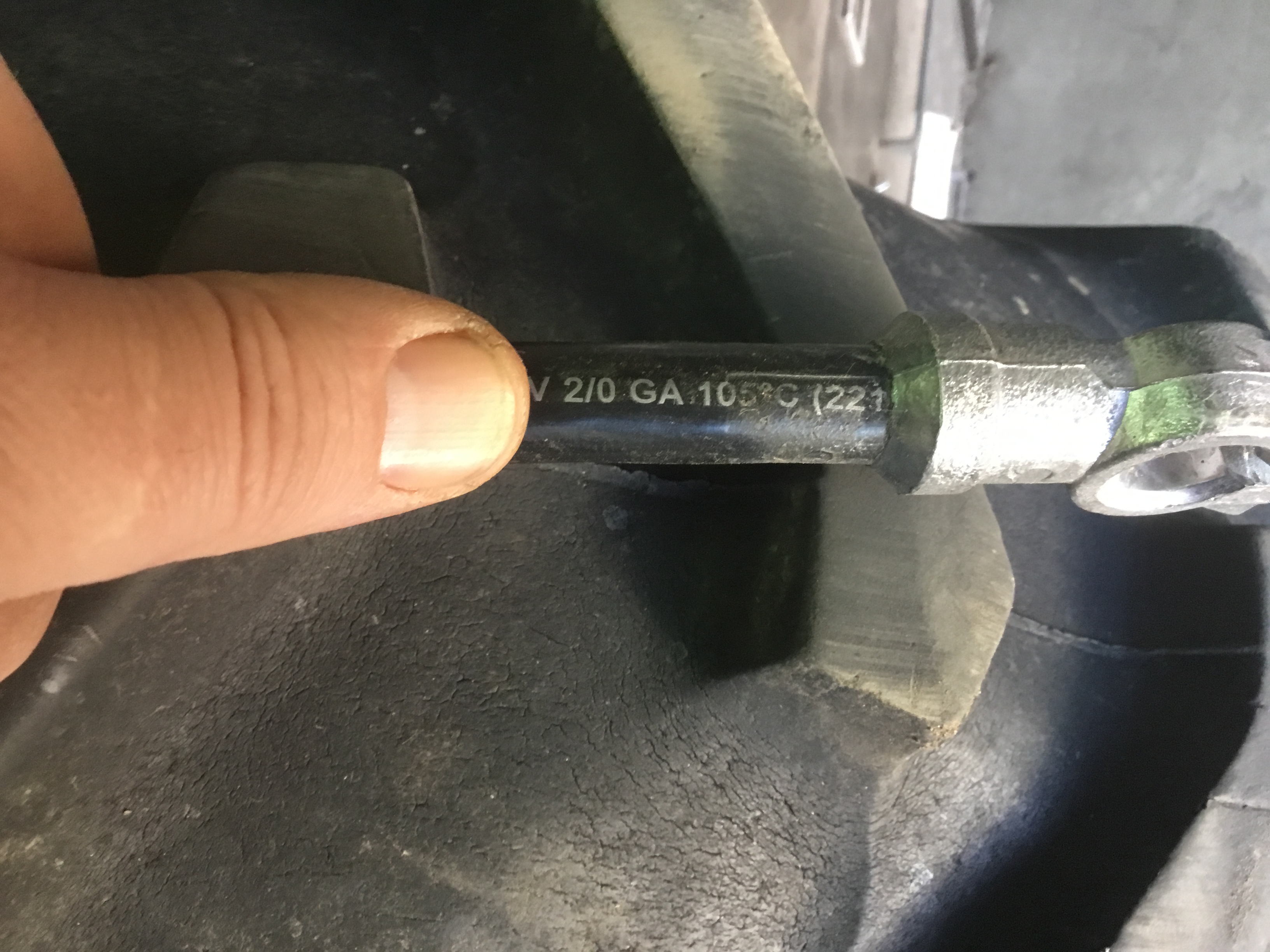

Also I’m pretty sure I have the appropriate sized cables on the battery ... they’re definitely larger then car cables

Hey would you take a pic of where you put the crank?

I use the 2/0 on my CA.

Took awhile but here's the pic of how it's stored on mine:
Think its cool how the screw on deal has one side larger/heavier than the other...putting gravity to work even if it's just screwed on lightly it'll never loosen up completely!
