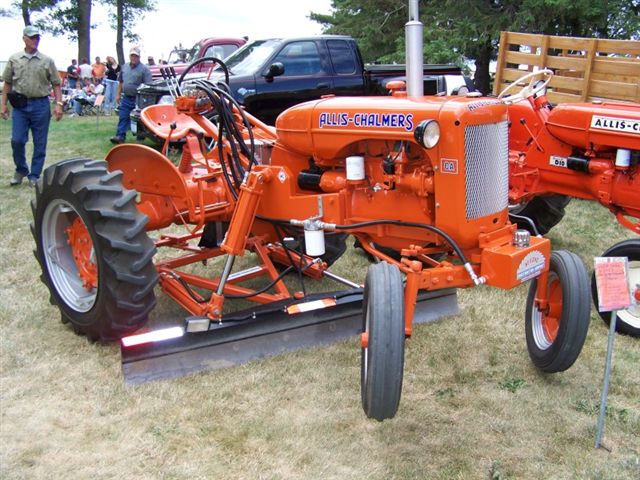

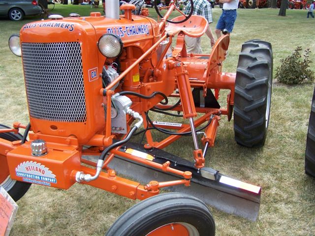

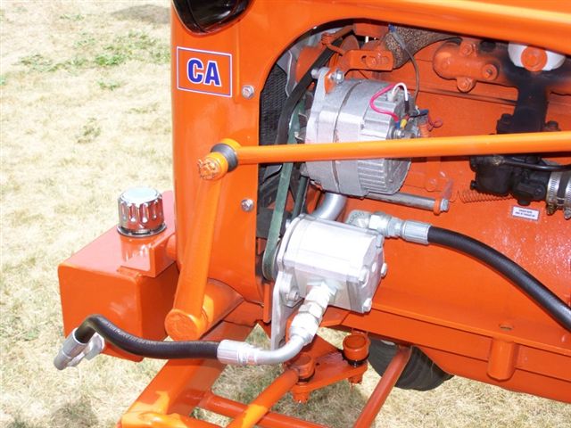

Post Options Post Options   Thanks (0) Thanks(0)   Quote DSpears N IL Quote  Post ReplyReply Direct Link To This Post Posted: 07 Sep 2018 at 8:00pm
I saved these pictures from the Go-To in New York several years ago!
Do not know who's the owner or builder, but Very interesting to me!
DeWayne
