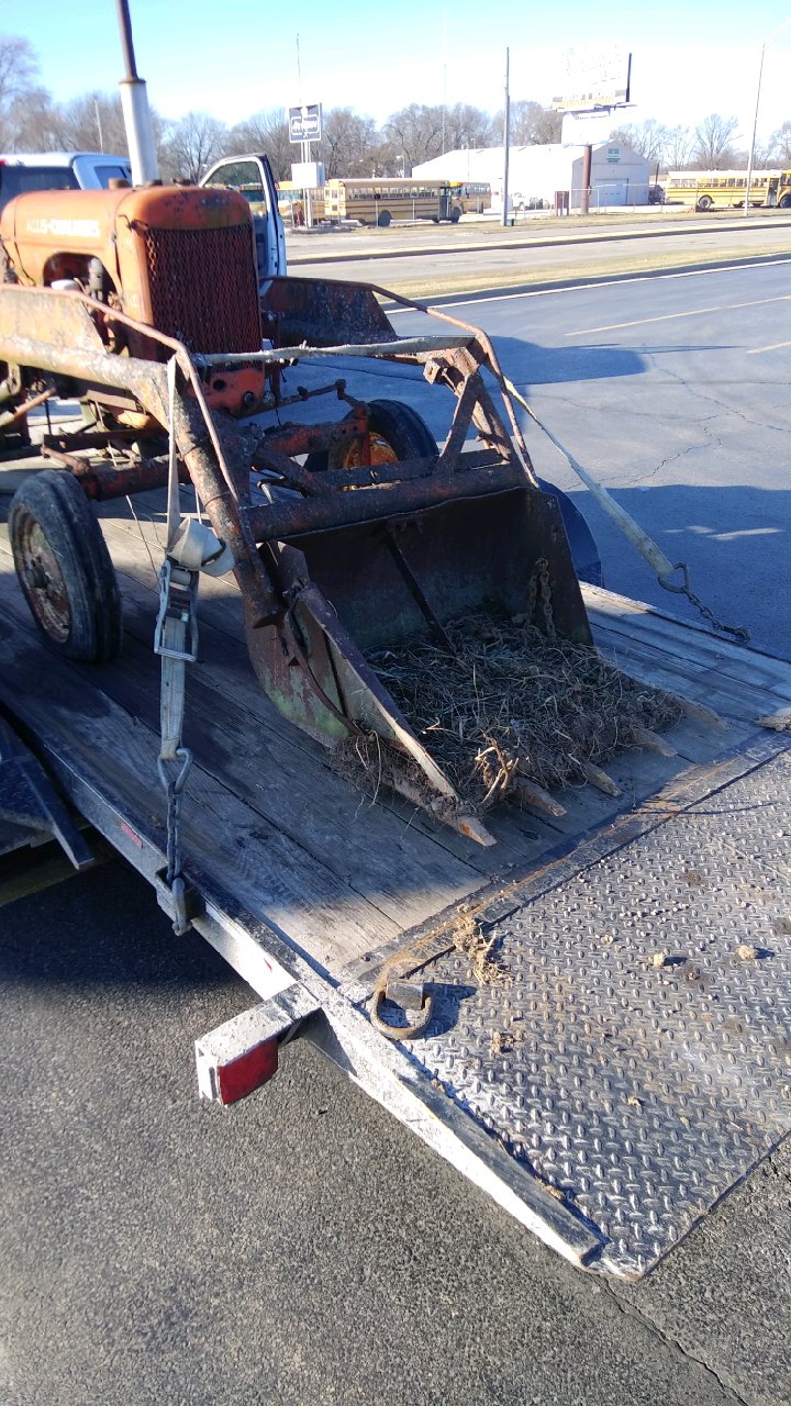

What can anyone tell me about the attached picture of front loader I'm going to put on my CA? I'm looking for lift capacity and if anyone knows the maker of this?
Also if anyone would know the maker of it if they would have a operating manual for it or any other kind of information would be greatly appreciated, thanks Matt

My vote is Midwest loader

I agree also that the loader pictured is not an Allis #8 loader for a CA. As for lift capacity, I have a #8 CA loader and with a properly functioning hydraulic pump it will lift near to 1000 pounds. However when lifting that much it is impossible to steer.

I don’t know about that loader, but it looks similar to the Allis #8 loader, but not the same. The manual for the #8 loader said the lift capacity was 1500 lbs. Your loader may have similar ratings.

Could someone confirm the normal operation of one of these as used on a CA?
I'm told it only raises on hydraulics and has a cable to trip the bucket?(so I'm picturing this setup as I'm using it to clean up hay from behind my barn)
Drive into loose hay left on ground from cows, hydraulic lift up, back up tractor, trip bucket to dump load, then what?( Need to get off tractor to rest bucket into locked position to get next scoop, then lower bucket back down, drive bucket into pile to get next scoop?

Reset bucket

Lower the arms and drag bucket in reverse. It should latch if adjusted right. Lift clear and go get another bucket full.

It is a balance of weight around the pivot, there is a chance it may rotate back and latch when the load is dumped out.

 It will latch itself most times, IF it has the proper return spring on it.
