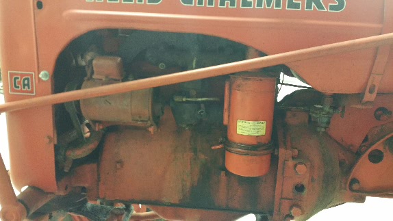

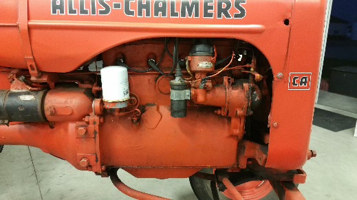

I have a late model CA with a snap coupler. My others are early CAs. I was looking at the AM numbers on the sides of them and found that my late model snap coupler CA has a different AM number on the right hand side...they all have the arrow head shaped extrusion to the right of the dipstick. I like things original... Could it be that my late model has the wrong motor?
Early CA Numbers AM 2916 33
Later CA Numbers AM 4033 1
Thanks!

That number is a casting number. casting numbers changed every time there was a new pattern made, or at least when there was an engineering change in the casting.
 PA is a gas designation for a later model engine , probably with a bit higher compression than a GA engine.

I don't think any 2916 block will have the casting for the fuel pump. My guess is the casting number changed when they added the material for the fuel pump.
How long was the 125 power unit still available after CA production ended ?
The last digit on the casting number is the date code.
I think 1938 was -10.

Nathan, I have two of the 2916 blocks with the arrowhead casting extrusion by the dipstick....

I just found some pictures of a couple too. The date code numbers are high 20's? or 30 on those?
Post Options Post Options   Thanks (0) Thanks(0)   Quote CTuckerNWIL Quote  Post ReplyReply Direct Link To This Post Posted: 21 Aug 2017 at 8:37pm
That "date code" doesn't date the block worth a hoot. I have a 51CA with the original engine. My Dad bought the tractor new in 1951, and the "date code" says its a 1956 block, but the tractor number and engine number are BOTH early 1951.
 I have talked to other people with similar tractors.
