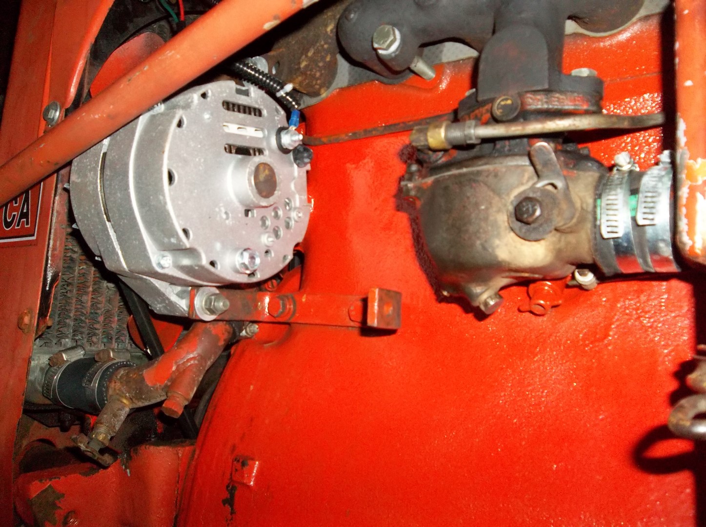

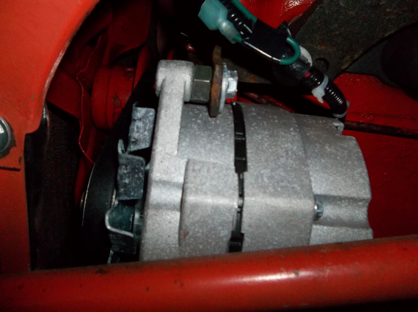

Post Options Post Options   Thanks (0) Thanks(0)   Quote 1955CA Quote  Post ReplyReply Direct Link To This Post Posted: 17 Dec 2018 at 8:17pm
Sorry I don't have part numbers, but yes it can be done. Here is my CA with a 12V alternator. My friend that converted it said it is a GM alternator but I don't know what model it is.
I can try and see if there is a number on it tomorrow.

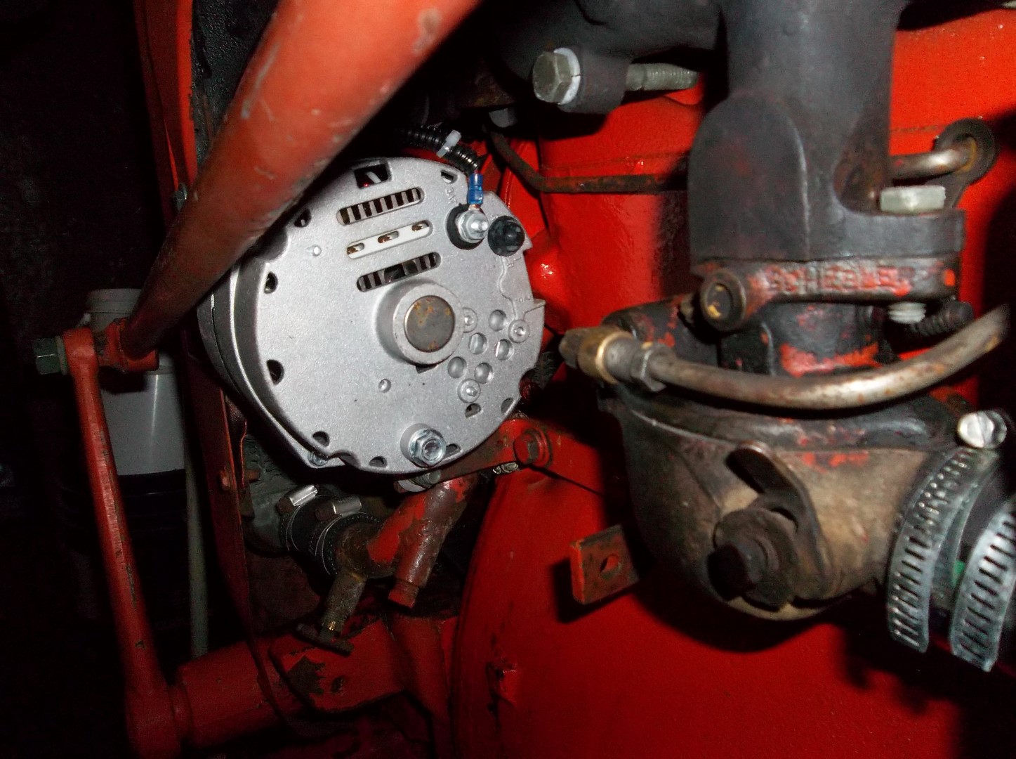

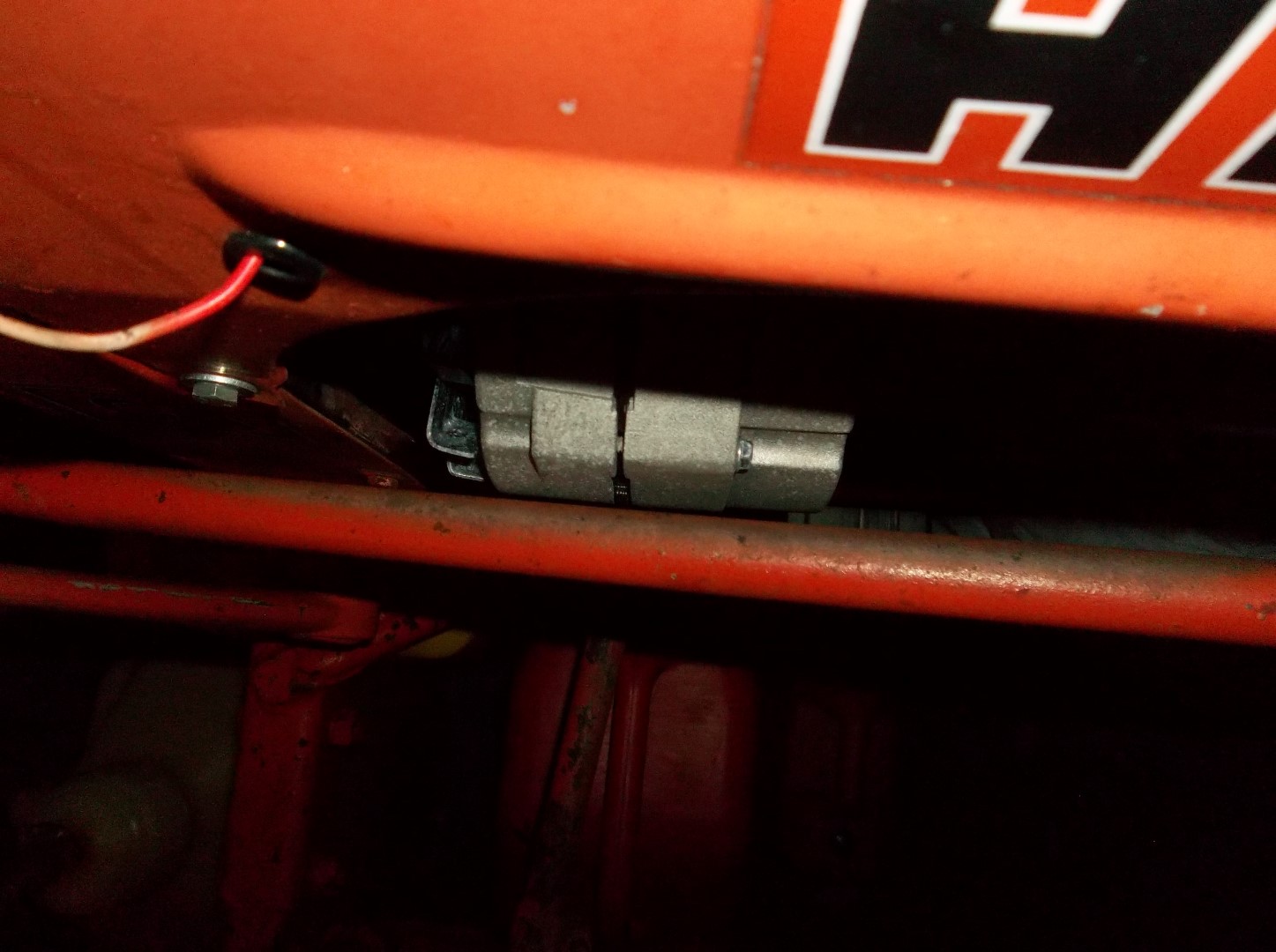

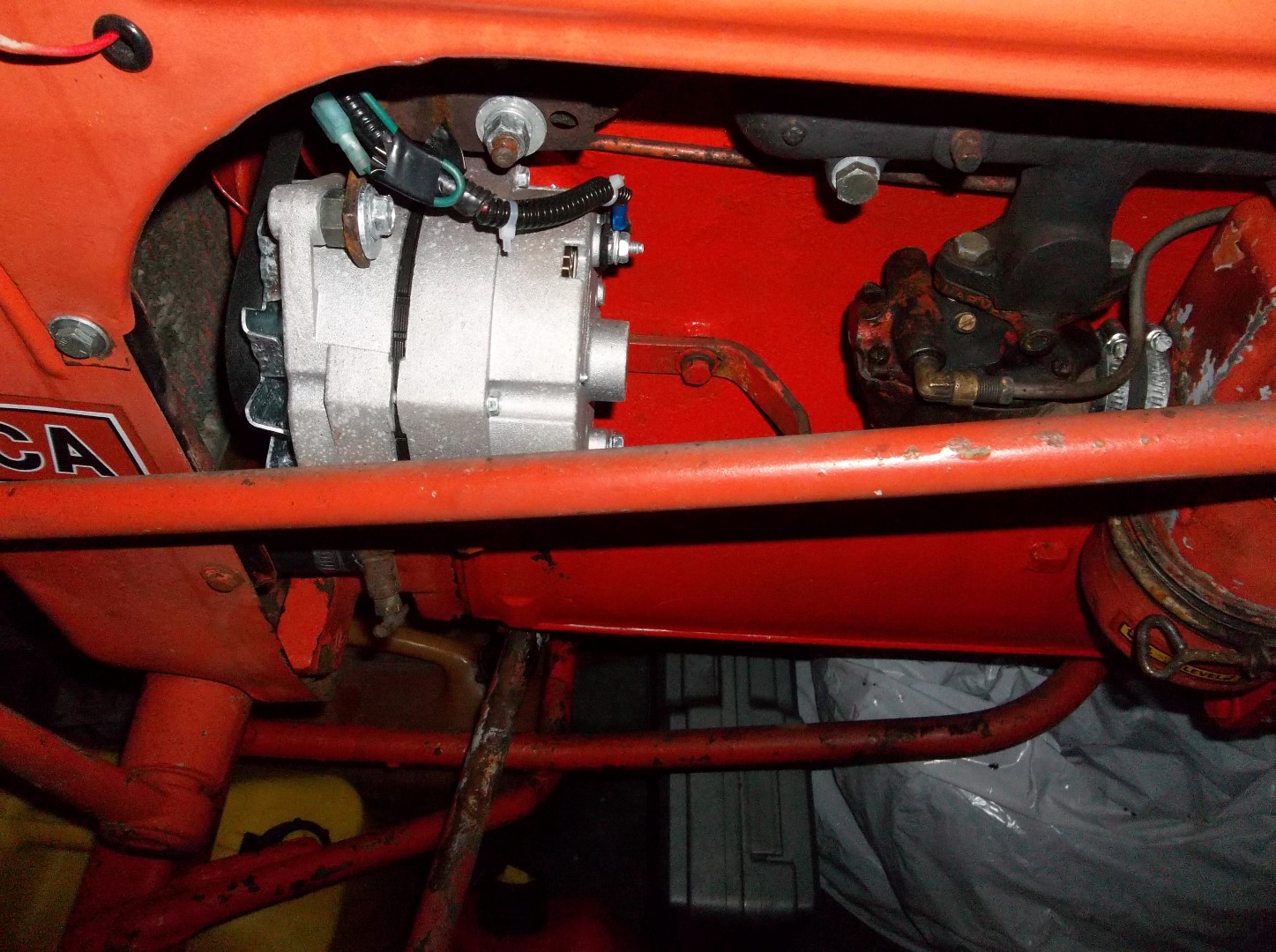

Post Options Post Options   Thanks (0) Thanks(0)   Quote Leon B MO Quote  Post ReplyReply Direct Link To This Post Posted: 18 Dec 2018 at 5:30pm
I did get some pics of the alternator on the CA, I used the pulley that came with it and made my own brackets. This is my mowing tractor and it's been on there 2 seasons with no trouble, it will self energize at less than half throttle.
