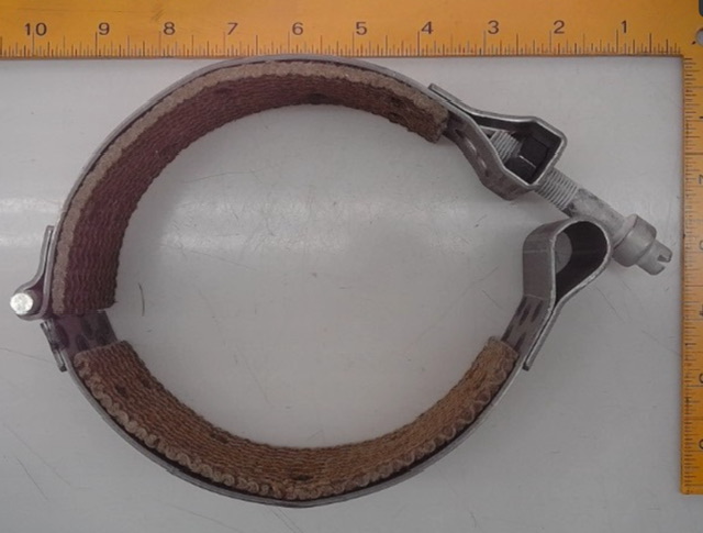

Post Options Post Options   Thanks (0) Thanks(0)   Quote Mikez Quote  Post ReplyReply Direct Link To This Post Posted: 18 Dec 2023 at 8:43am
These are available 276965

Lynn Marshall View Drop Down
Location: Dana, Iowa
Points: 2483
Post Options Post Options   Thanks (0) Thanks(0)   Quote Lynn Marshall Quote  Post ReplyReply Direct Link To This Post Posted: 18 Dec 2023 at 12:37pm
Mike , the bands in your picture use what I would call a webbing material for the lining as opposed to a regular brake--clutch type material. Have you used that type before with good luck? Anyone else out there have an opinion on them??
Cernunnos View Drop Down
Joined: 30 Jul 2014
Location: Ridgeland, WI
Points: 363
Post Options Post Options   Thanks (0) Thanks(0)   Quote Cernunnos Quote  Post ReplyReply Direct Link To This Post Posted: 18 Dec 2023 at 2:12pm
Yes, from my experience the braided fabric (I think it has brass fibers threaded within it) has superior braking power over the clutch type bands.  That type seems to glaze over and doesn't seem to make great contact with the drum.  Rick relined my bands with this type of material, and I am very pleased with the results.
dfwallis View Drop Down
Joined: 09 Mar 2023
Location: DFW
Points: 931
Post Options Post Options   Thanks (0) Thanks(0)   Quote dfwallis Quote  Post ReplyReply Direct Link To This Post Posted: 18 Dec 2023 at 2:42pm
Most of the standard (including the common light gray I just bought for my CA)  brake/clutch linings also contain a mixture of metals, usually including brass, copper, iron, or steel.
