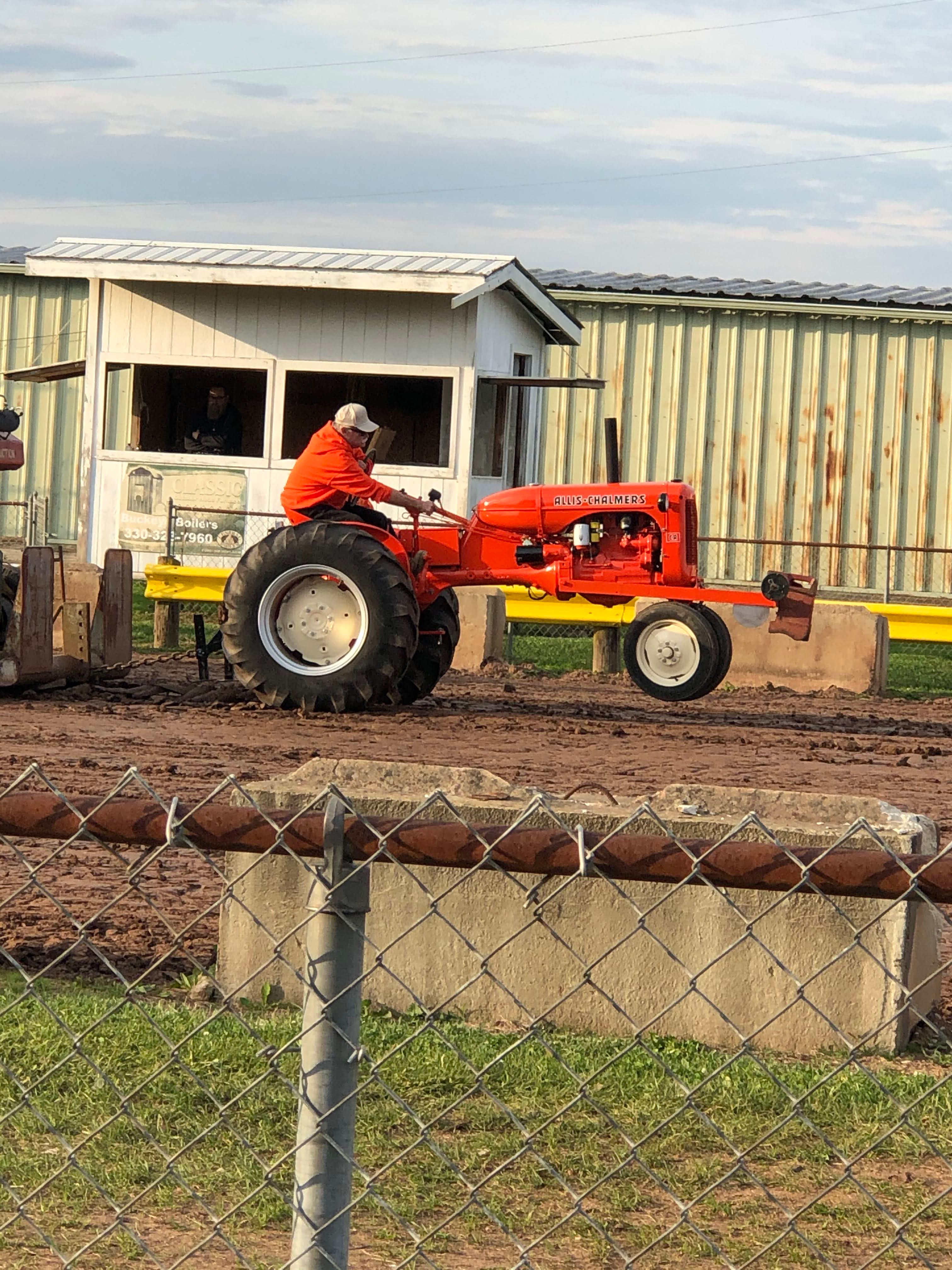

. Another great year for my Paul Barnsley built CA. We were so fortunate that our local track Mile Branch Grange , Sebring OH canceled only 2 pulls because of Covid , started back up in May and ran the rest of the season. We were pleasantly invaded by pullers from other states and local folks we had never seen. Biggest night was 363 hooks. I was never beat in 2750 or 3000. I’m very competitive in the 3250, probably won the track championship. There’s a WC that beats me now and then and it’s so fun to beat Farmal H’s and 230. Barnsley is the wizard of H.P. in the world of CA’s!

What size rears you have on there?
Charlie
Points: 5270
Post Options Post Options   Thanks (0) Thanks(0)   Quote PaulB Quote  Post ReplyReply Direct Link To This Post Posted: 06 Oct 2020 at 10:49am
They are 14.9X24 old style 45 degree tires that were road worn and I trimmed up the tops a bit.  They are a great match for the power that tractor has in 2nd gear for the light class.

Post Options Post Options   Thanks (0) Thanks(0)   Quote Charlie175 Quote  Post ReplyReply Direct Link To This Post Posted: 06 Oct 2020 at 11:08am
I had thought about using 26's from a D15 but they are a wee bit expensive

That guy in the shack looks all pis.ed off, !

Dose not look like a CA engine
nonetheless ,still dead.

Its a Div 4 or Class B at the tracks she pulls. Meets every rule stipulation of those particular class’s.
