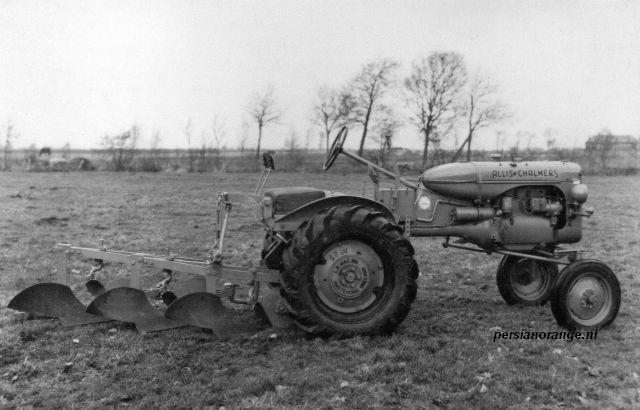

Mounted or pull type, what kind of soil? Given the right conditions, enough ballast and proper settings, it could pull 3 but I have seen guys trying to pull a 2-12 pull type and do nothing but spin, then can't get the plow back out of the ground without help. There is a factory picture out there somewhere of a C or a B with a 3 bottom mounted plow. The only mounted plow I know of that Allis sold for the C was 1 bottom. The 2 way plows had 2 bottoms but you only used one at a time.

We have a forum member that pulls a 3 bottom with his CA but a C would probably not move with 3 bottoms in the ground. I'd love to be proven wrong though! I just don't see how it could happen. Maybe with a newer, larger motor?
The C and the CA and later B's all have the same engine. Look at the right rear wheel. You can see dirt from the furrow on the tire. I believe this might be a factory photo????
They do all have the same engine, more or less, but how the heck are you going to put a 3-bottom mounted plow on a C? That's the difference here between a C and a CA, not so much the engine horsepower like you seem to be thinking. It's the application of that horsepower. You can pull mounted plow (especially with the Traction Booster of the CA, another key difference) with more bottoms (or larger size of the bottoms) than a trailer plow.
With enough modification, you could do like that picture shows but I'm figuring the average guy is going to be using a trailer plow, and I don't think a stock C is going to pull a 3 bottom trailer plow. Maybe with 10" bottoms, or some realllllly light soil...

I don't think you could pull a 3 bottom trailer plow. Like I said in the reply just before the one you read, I watched a guy trying to plow with a 2 bottom trip plow and he couldn't do it. With the right conditions, a properly weighted tractor, I believe a 2 bottom trailer plow would work, 2-12's for sure. I also don't think there were too many "modifications" to the tractor pictured. The modifications would be to the plow to attach to the original rock shaft pictured.

Yes, the modifications I was referring to were to the plow and mounting hardware. Practically (ha!), I think you'd have to modify a snap coupler 3 bottom or three 1 bottom B-C plows and rig it up to fit. And go through all that work, knowing you still don't have traction booster... my vote is still "no" regarding 3 bottoms on a stock model C.

There is nowhere near enough front wieght on that B to lift the 3 bottom. My C with the 1 bottom mounted gets very light in the front. In heavy clay with roots and rocks. just pulling will raise the front. when you get to the furrow end and lift the plow the front tires come up before the plow comes out of the ground. once the suction breaks then the plow comes out and the tires go back down.  I could go out and hook my 2 bottom snap coupler to the back of my CA but I would not even try to pull it. In My heavy soil it makes the WD45 work.

Could the B&W photo of the C and 3 bm plow be in Europe? Being is has after market headlights and sorta turn signal lights mounted lower in front.
Yes, the Netherlands. the web address is on the picture but I can't read the words on their siteLOL
