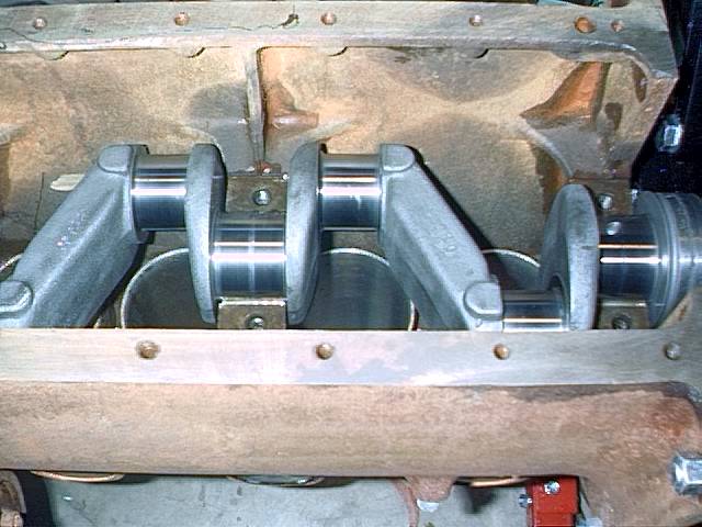

Here is a 4" stroke crankshaft in a C block.  The picture shows where I ground the block web for clearance. I removed .150 off the head and installed Chevy small block valves.  I custom made the pistons so the top of the under the firing chamber went in .250. I used a D 15 camshaft that I sent to Crane cam in Florida. I drilled the crankshaft for a pressure system and used the D 15 oil pump. I had a shop ballance the crankshaft and pistons alomg with the flywheel.  I worked on the carburetor until it would run 4000 RPM smooth.  I used an adjustable restrictor plate in the manifold that a normal inspection would not detect.  With me doing the majority of the work the bill was a total waste of money. Way too much power to hold traction in a 3 MPH pull.
Some of the pictures I took when building.

Dick: Is that the engine that you showed me with a BIG hole in the side of the block?
No that was the engine I built for a B and shortened the rods for the 4 inch stroke. One of them had a weld that didn't hold. I machined a 3/16 plate and used two head gaskets to use somewhat standard pistons.  I spend hours making a fixture so the rods would be exact and true and then messed up on wone with the weld.  My first and last try at shortening rods. That was the second 4 inch stroke crankshaft I had made for thos engines.
That was after you were here to get the D 15 block. I think you got the head for the D 15 as well.
