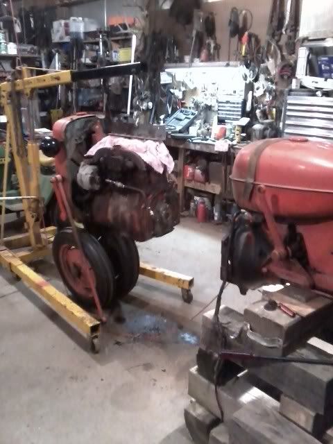

Previously, I lost oil pressure on this tractor. Switched gauges, still no pressure. Took the oil filter off, and nothing came out of the oil feed line while running (Did not run it for long.)
Well, just cracked open the tractor tonight. Oil pumped checked out good. Spring and detent ball were functional, as well as the propellers inside, everything seemed to be working well.
Took the air hose, and blew air back through the oil spout that feeds the oil filter. A little sludge and oil came out of the line, but not enough to make me think it was blocked there. Then, took the pan off, and blew air back through the oil pick up, in the pan. clean as a whistle.
Finally, took the entire oil filter housing assembly off the block, and put air through there too. Clean.
I don't understand this one, at all!! Any ideas?
Could anything be broke, from where the oil feeds the cam, through the block up to the oil filter housing (picture above)?

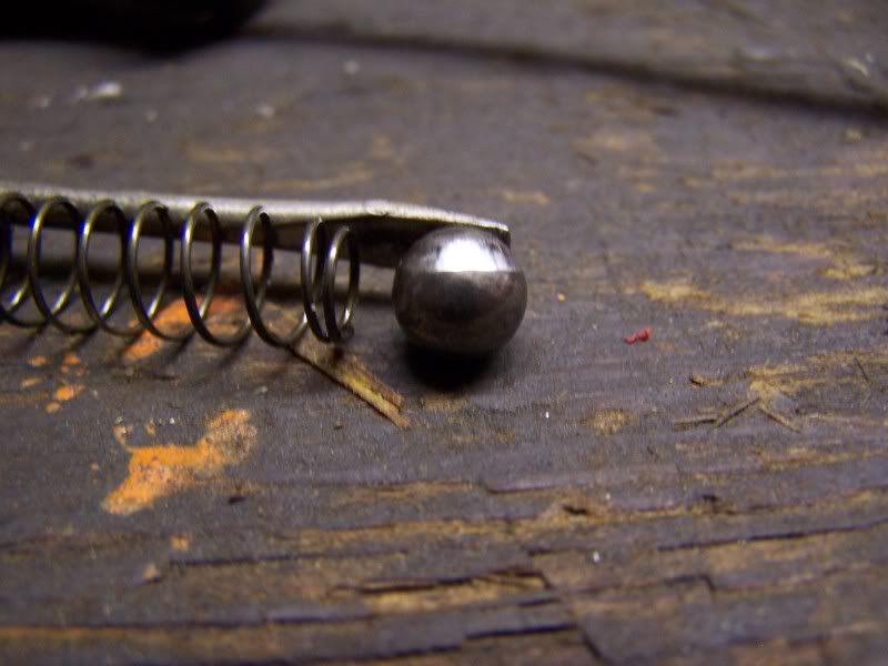

Also noticed, in the old oil pump, that ball was worn in behind the spring, had a flat groove kind of worn in it. Will have to take a picture of that tomorrow.

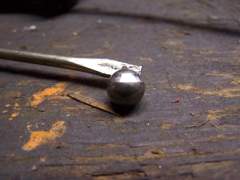

Pulled the old oil pump apart, Here is the ball and spring
Hard to tell in pics, but there is one side that is flat, in a ring type shape around the sphere of the ball. I bet that is what caused it to not seat properly.
