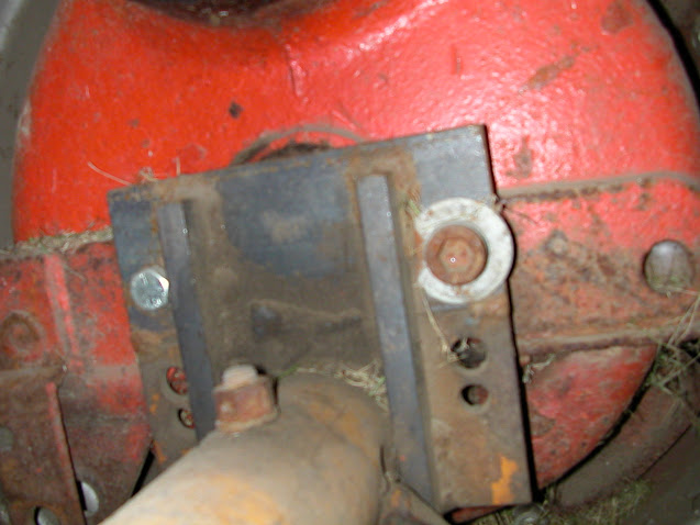

can someone post a pic of where the bracket bolts to the axles ? does it go in the forward most holes or the rear set where the drawbar goes??   ....Jb
8050 FWA, 190XT, 185, Styled wc, Unstyled wc, (2)C, (2)WD45NF, WD45WF, WD,416h, 716h, 312h, 8070 pedal.
Post Options Post Options   Thanks (0) Thanks(0)   Quote CTuckerNWIL Quote  Post ReplyReply Direct Link To This Post Posted: 30 Jun 2012 at 5:01pm
Neither set. It bolts up to the 2 sets of threaded holes. The far front and rear holoes are for a pin in the drawbar bracket. The drawbar can be left on in place of spacers behind the mounting flange.

Post Options Post Options   Thanks (0) Thanks(0)   Quote jb from md Quote  Post ReplyReply Direct Link To This Post Posted: 01 Jul 2012 at 7:50am
Thanks for putting up a pic , as soon as my block comes back from machine shop jail ill be putting the mower on it....Jb
