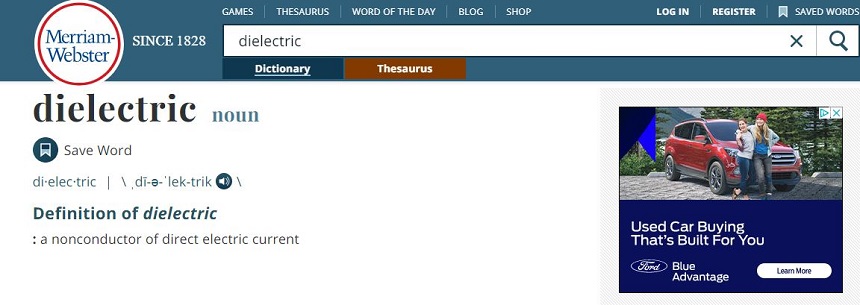

Would dielectric grease help?

I would not put anything on the contacts.  They need to be clean and dry.  Just plan on rubbing a piece of brown paper bag, a dollar bill (or higher if you want), or such between them before you try starting it after it has set for an extended time.  Often the paper is all it takes to remove the oxidization from the contact surfaces.
Dielectric grease works to seal plug in connectors or sparkplug boots but the metal terminals themselves have to have metal to metal contact.  I would not put it on the contact points.
