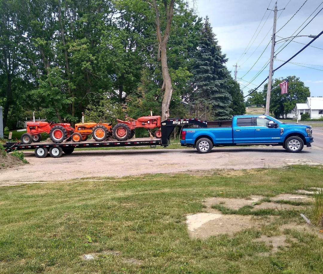

As an example, here is a picture of my truck and trailer, getting ready to go to a show last year. The trailer has a GVW of 16,800 lbs. and weighs about 4400 lbs. empty, which means I have a capacity of about 12,400 lbs. The truck has a gooseneck/fifth wheel trailer capacity of 21,700 lbs.
