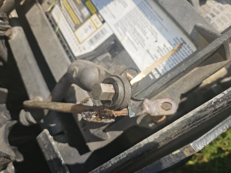

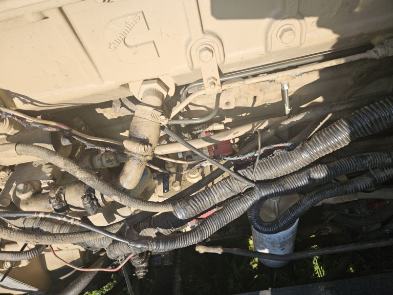

Fortunately, it did not happen on any of my Allis Tractors, but it happened on my GMC General semi with a Cummins 855 motor (not original obviously).  Great running truck but it doesn't run now.  I wonder if it could happen on my tractors though.  Regardless, I really want to understand how replacing a battery caused all of this.  I also need to get a game plan on fixing it.  I was hoping the electrical gurus on here could help me understand what went wrong and suggest an approach on splicing the wires.
First, this truck has had a lot of rig wiring jobs done on it.  The wiring harness picture shows the melting of the wires.  It melted the wires at the battery terminals too in the other picture.
The big fat portion is where all of the smoke came from.  Why did it melt in the center and not the ends?
I am supposed to have 3 batteries and there are three large capacity wires that go from positive to positive to positive and negative to negative to negative.  I put a new battery in place and before I could remove the 2nd old battery, my wiring started to sizzle and melt.  I never got the 3rd one in place.  I tried to disconnect the two batteries from each other but before I could do that the cables melted on the terminals and made it very difficult to get cables off.  By the time I did, my wiring harness melted in the center.  I checked the voltage right after installing the 2nd battery and it showed 10 Volts so it was lower than it should have been.  It is almost like the old battery was dragging it down but also causing it to heat up?  Can anyone shed some light on this?  I don't want to do it again.
My starter on this truck is a 12 volt starter.  I assume I have to replace all of the wires and not just the burnt portions.  I don't know how many I have in that casing yet.  I am not an expert electrician but I think I can splice wires with the right gauge.  Do I have to consider other things?  Anybody had to do this before?
Thanks in advance for any insight.

I would start at the jury rigged wiring that you describe.  That's usually where issues like this come from.  A lot of people will say "It will work fine!" even though the job was sketchy as hell.
If the wiring on your tractors are in good shape and not bodged together, you should be good.  However, it never hurts to look things over now and then to check for any melting/scroching or insulation wearing off from rubbing against something.
I can't help with the wiring on your General, but that cable at the battery looks to be too small for the load it was carrying.  You might have to go through that rigged wiring and remove what is not needed and redo what is needed.

3 batteries in PARALLEL is a LOT OF CURRENT... and a 855 Diesel pulls a LOT OF AMPS..
I would agree with Dseries4, that cable is WAY TOO SMALL... Dont know why it picked now to fail, but i would put a ALL NEW batterie cables on and make them BIGGER... your cable looks like a #4 .... a #2 would probably be to small .. #0 would be minimum....#00 would be better.

1st problem in the 1st picture is that homemade battery cable' ! The end is NOT properly crimped onto the cable. That alone could have easily burnt the truck down to the ground.
2nd problem, sounds like you have mismatched batteries. It's a BAD idea to just replace one of 4 or 1 of 3 in your case. The 'weak' battery WILL 'pull down' the others to it's lousy level. Smart truckers replace ALL and make sure ALL are same brand and model. best it to get from same batch if possible. When you replace the batteries you ALSO replace ,at the very least the MAIN fat power cable going to the starter.
OK, so it costs a few bucks BUT you now KNOW you've got LOTS of amps AND the wires to HANDLE that power.
Bodging or being frugal WILL leave you at the side of the road !

Agreed that cable looks pretty wimpy, and also a bad battery/ies with one or more shorted cells would cause said batt's to pull down HARD on a fresh fully charged unit.  It's possible that one of your connections inter-battery wasn't the greatest (likely a ground) which then caused the current to find it's own path back to the bad battery through whatever wires melted.
First order of business is as mentioned, pick up 3 new matched batteries & some suitable gauge power and ground wiring/properly crimped terminals but before installing those, open up the loom that smoked & identify how many wires you have melted & what they fed.
With that information you can probably find how big of a mess you have (hoping for your sake it's confined to under the hood & not into the cab anywhere), replace all burned wires and check insulation on the rest of the harness.
If it was mine, I'd then do an ohms check between your new + and - terminals with everything switched off.  This is to check for any further shorts, a small resistance (somewhere down to maybe 250 ohms between + & - would be acceptable if you have alarms/clock etc on full time power) BEFORE attempting to connect the new batteries.
Also would 100% recommend a disconnect switch in line with the new batteries so you can quickly kill power in future if anything goes awry. And definitely attend to any rigged wiring as soon as you can!

You need to cut into the burnt harness and repair all the small wires first.. Look for OLD damage and NEW damage and fix everything... When you think you have it all repaired, connect ONE 12 v battery.. old or new... and test everything.. lights, radio, accessories ... Then bump the STARTER motor.. solenoid should CLICK, but wont turn over with only one small battery... IF everything looks good... THEN install the new batteries and cables and double check + to + to +...

I am going to post some more pictures and there is more to the story as I look at the wires and think through the event.  I was lucky that I had the hood up while I was do this otherwise, I wouldn't have seen it and it would have burnt into the cab.
I have done some research and know that over capacity current is what melts wires, not voltage.  The smaller wires melt first, which is what I saw happening.  What caused the high current has to be a differential between the old battery and the new battery.  Nothing else makes sense at this time so while I had the right idea to change all batteries, I should have disconnected all of the batteries before connecting up the new one.  Then connected the next new one and the next.  These all would have been on a equal voltage value and not caused the differential but I am not an electrical guy so I could still be wrong.  I am definitely setting up a cutoff switch.  However, there is a cutoff switch inthe battery compartment that I found and I do not yet know what it is for.  I am going to track down and document all of my major wires.  Maybe that will make it all clearer.
There may be another part to this story though.  It seems that the fried cable I took a picture of does not go to the starter.  It is a negative cable that I have to track down.
I do have the very large 0 cables going to the starter, but I didn't take a picture of them yet.  They didn't burn because they were so large.  They did melt and at the battery terminals.
It was a sickening feeling watch those cables melt and burn and realize I could not stop it because I couldn't disconnect the melted terminals.  It was a frantic couple of minutes to say the least and I felt like it was headed to the cab too.
I am going to cut open the plastic protocter and see what I have inside.  My guess is the smaller wires are melted.  The larger wires are compromised.

I think I might know what has happened.  The fix may not be as bad as I thought.
I pulled open the split wire plastic loom and found only two wires were melted.  Turns out that those two wires plus the wire I showed in the picture were all attached to the alternator.  It appears that the burning started at the alternator which was on the other side of the truck.  Basically, after I connected the new battery it probably started burning then and was working it's way to the other side where I was at.  By the time I saw it, it had already burnt the other side.  The large gauge wire did not melt through like the smaller gauge wires but was on it's way.  Here is a picture of what I think I have.  This fix may not be too bad.  Not sure if it fried the alternator though, but that is easy to figure out.  I missed showing the negative cable going to the truck frame in this picture.
The one oddity is the cable going to the alternator.  It was attached to the negative ground on the battery.  That doesn't seem right.  Normally, the alternator gets it's ground from the engine and there isn't a special cable, I thought?  So, I am going to have to look closer at the alternator.  I have a new suspicion that maybe someone might have made a mistake when they put the battery into the top spot.  I think that cable goes to the positive terminal on the alternator and not the ground.  The reason why it didn't previously cause a problem is because the top battery was not connected to the bottom two batteries.  As I started to connect all 3, that is when all hell broke loose.
If that negative cable  going to the alternator was really supposed to be the positive cable and was criss-crossed incorrectly, would that have caused the alternator connections to burn wiring?  Possibly.  It's really about the only explanation.  It really looks like the burning started on the other side where the alternator was.  I am going to have to look at that Alternator and try to figure that large cable out.
Here is more of what happened.  This is the alternator on the other side of the engine.  There are two small wires and the large wire, all are burnt.
If you look closely, those two wires going to alternator stopped melting, right here.  So that is going to be my splice point for those two.
while the loom is melted, these wires appear to be fine.  The loom melted but not the wires.  There are a lot of wires in there so that is good.  I will pull the loom off just to be sure though.
you can see I have the big gauge battery cables.  They are all fried so they have to be replaced.  They look expensive.  You might be wondering what that cutout switch is for?  Me too.  I think it may be cutoff switch to the rear tail lights.  They have a tendency to stay on but I didn't realize this cutoff switch turned them off.  I traced it to the back of the semi but lost it without a light.

I was just rolling back up and the circuit breaker I'm referring to is right in your picture! I didn't see it the first time. My old eyes aren't catchin' things to fast anymore.. LOL!

Thanks for the info! That cicuit breaker does not have anything to do with alternator wire. It goes to the rear. There is a problem with the rear taillights staying on and i believe that cutout switch is used to turn off the taillights. When i fix the alternator wire, going to put a fuse in place.

I removed the two small wires from the alternator and the large wire.  Ordered new wires.  I hooked up two batteries and they are showing 12.83 volts when connected in parallel.  I definitely have power to the key switch as I saw some dash lights come on.  When I turn the key, the solenoid clicks but it won't turn over the engine.  If I try the key again, the solenoid will not always click.  If I wait awhile, it will click once.  Is it possible that the solenoid was damaged or was going bad before I fried the wires?  Would one of those small wires that melted have been terminated at the solenoid and damaged it or be making a difference?  Could the starter have been damaged?  I know how to jump start my tractors with a screw driver but not sure how to do that with this semi.  Here is a picture of the starter, in case anyone knows.
I cannot add the 3rd battery yet due to waiting on cables but I think it was previously starting on one good battery so I don't think I need it.
Just would like to see it turnover and then start. I will deal with the alternator later.
Points: 90661
Post Options Post Options   Thanks (0) Thanks(0)   Quote steve(ill) Quote  Post ReplyReply Direct Link To This Post Posted: 31 Aug 2024 at 4:44pm
Clicking of the solenoid says you have POWER.. but does not guarantee the wire is GOOD SHAPE and can carry 1000 amps... Wire could be bad.. terminal could be bad... Solenoid could have crapped out ... but solenoid should not have been engaged when wires burnt, so no effect on it..
YES. you can jump it as you said... I would be looking at the BIG CABLES from the battery to the battery to the STARTER... and the GROUND cables for all.
