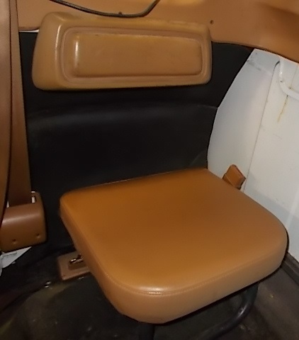

I need to update my original post, but i eventually got the buddy seat installed this fall. I used seat, this was the cheapest place when i bought one. On a side note there is a guy on the 8000 series Facebook page selling the piece of steel to weld in and the seat for $400. I made my own because i have a plasma cutter and was already cutting other pieces of steel for the cab, otherwise i would've bought his pre-made kit. http://https://www.tractorpartsasap.com/side-kick-buddy-seat-fabric-brown-new-127261.html

977.3Ford, your cab’s buddy seat looks great. Thanks for the follow up photo of it. I notice your tractor has GPS auto steer installed on it. How do you like it? How accurate is it? Did you upgrade any hydraulics for it?
