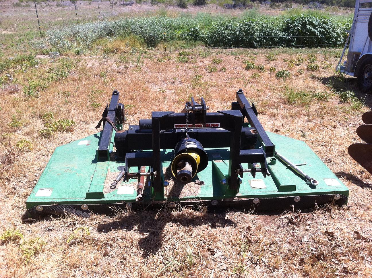

Bought this little jewel from the local JD dealer three years ago.  Eight foot made by Ag-Meier in Texas.  Pulls great behind the D-17 and if you drop it down right on the skid plates it mows like a finish mower.
