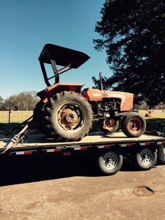

I didn't need another project but.... sheetmetal isn't too bad, recent clutch job. Shifts nice, brakes ok. Hydraulics and pto work fine.
Now the problem. Hard stater but I haven't checked to see if the glow plugs are working. Good smoke out of the exhaust when cranking. I think the rings are gone or stuck. It smokes a bit but what I don't like is when I pull the dipstick when running I get a pretty good amout of smoke there. The only ring set I have run accross is $800 for rings, rod bearings and gaskets. This is a Toyosha 2.3 3 clinder diesel. Anyone have any parts sources or advise?
