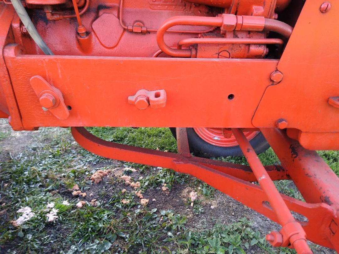

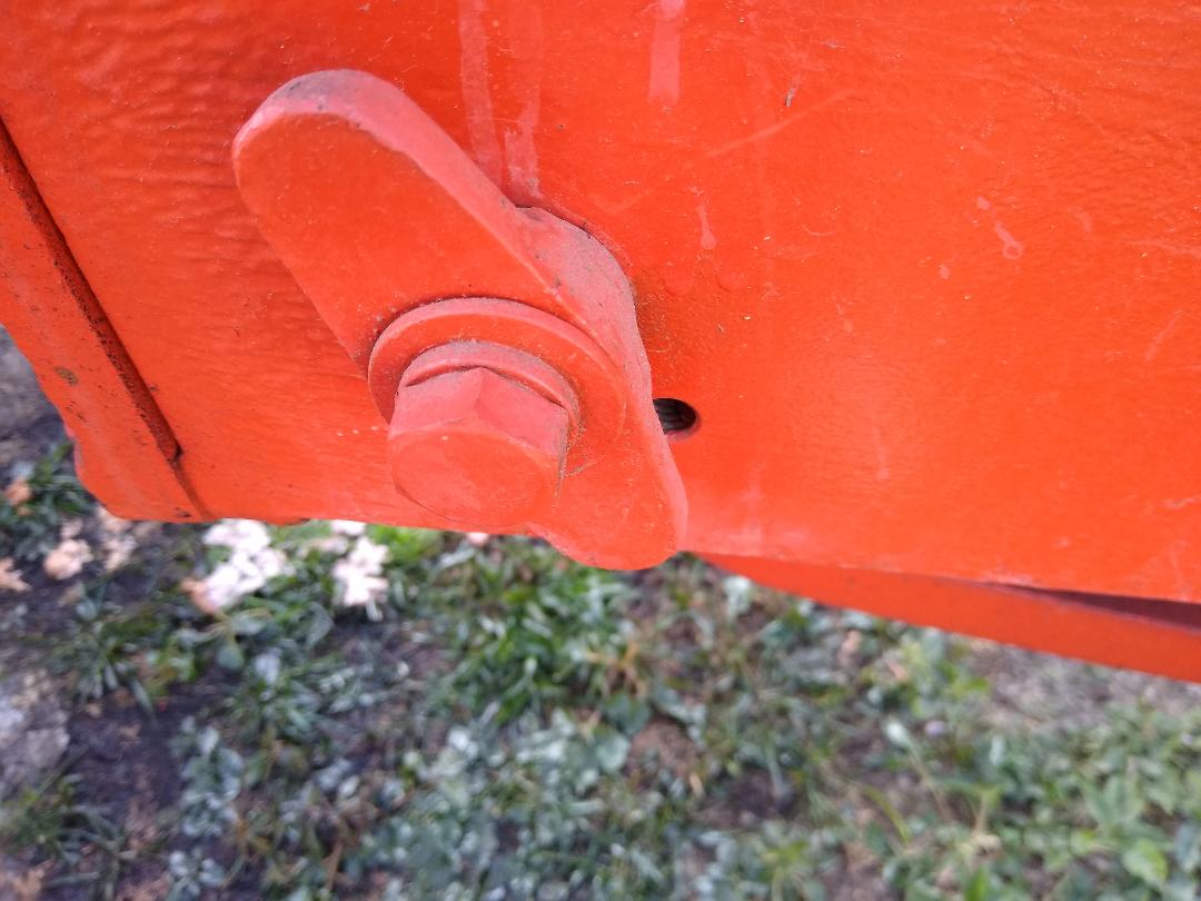

My cousin bought a D-14 yesterday and it has the brackets shown in the photos below on both sides of the frame of the tractor. Any idea what they are ?

Front mounted cultivator attachment, 3 each side.

Took a pair of similar looking jobs off my D 15 . Always wondered what they were for . They were right above the front axle . Thanks

Heck all I knew was that D-14 has power steering !!! Kinda jogs my memory, one of the fleet had them 'funny things' on them...as to WHERE I put them, well, there's 3 or 4 'safe places' here..somewhere.yeah, I'm, ah, well kinda sure, maybe...

3rd bracket is missing.  At rear is a big wing nut thingie, which holds the back of the cultivator frame tight to the frame rail.  In the middle, is the wedge holder, you hammer a wedge, against the middle of the cultivator frame, and up front, (missing) is a little eye, that a turnbuckle fits into, to brace and hold it tight..Wink
