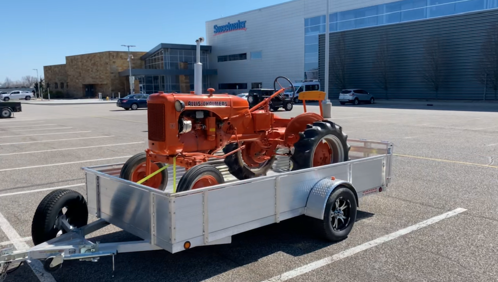

This past weekend, I purchased a 1948 Allis Chalmers Model B.
I now have 2 Model B's  (The other is a 1940 with hand crank).
The plan is to remove the belly mower from the 1940, and install it on the 1948.
Hoping everything goes smooth.
The 1948 drives real nice but I have noticed a couple things.
1. The steering is extremely sloppy. So much play in the steering wheel.
     I'm not sure how to solve this.
2.  The clutch engages instantly, popping the tractor.
     To combat this, you must very slowly release the clutch.
     (Could it be I need a new clutch?)
Thanks for any advice
